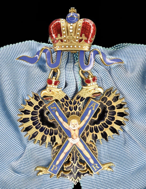

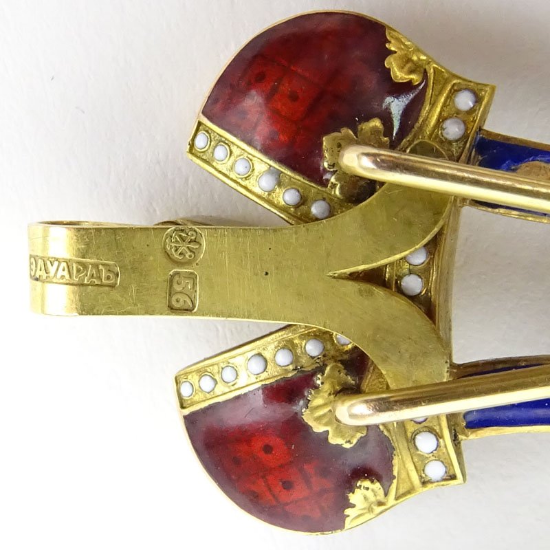

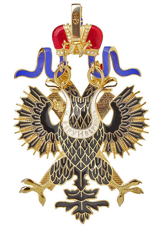

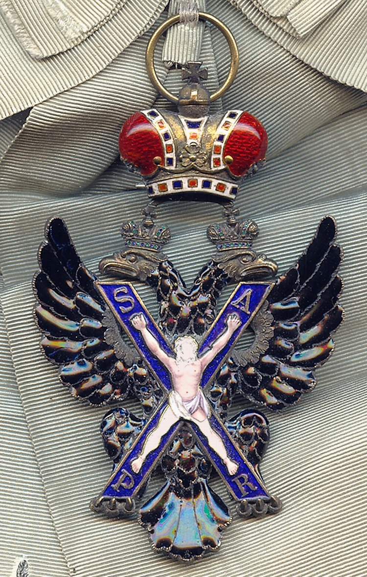

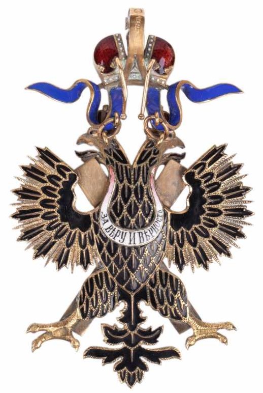

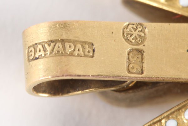

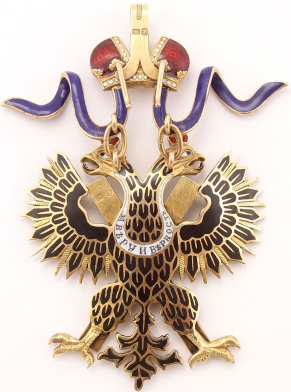

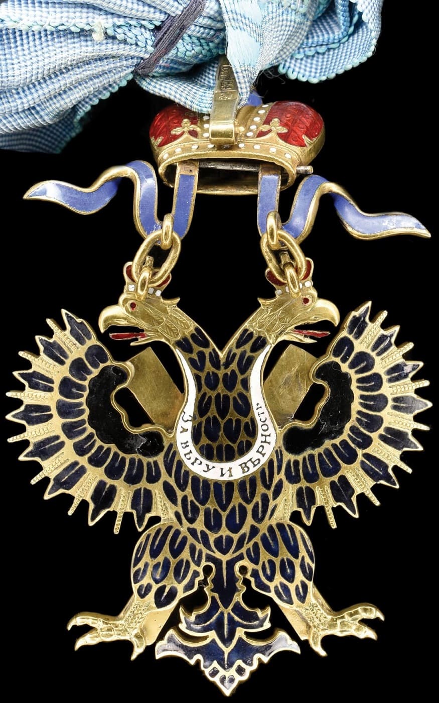

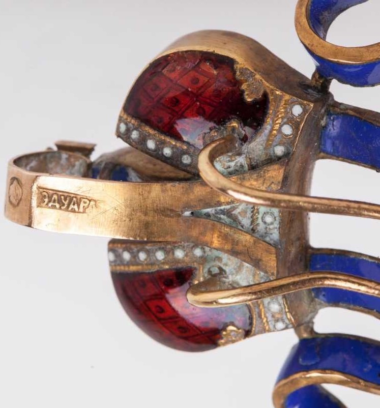

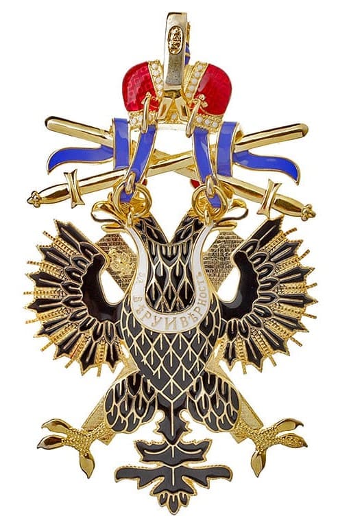

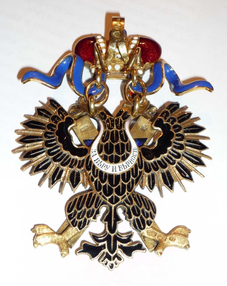

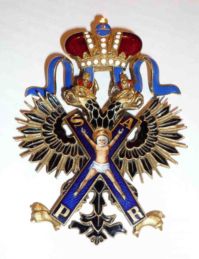

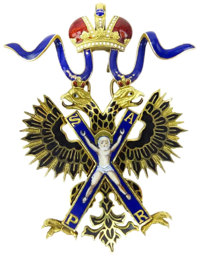

Fake "Eduard" badge.
Gold.
Size 95 х 62 mm.
Weigth 67 g.

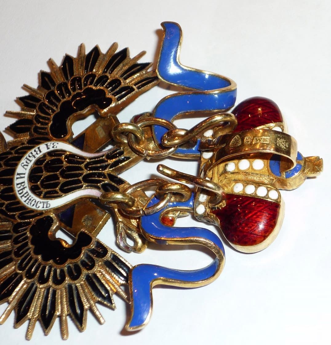

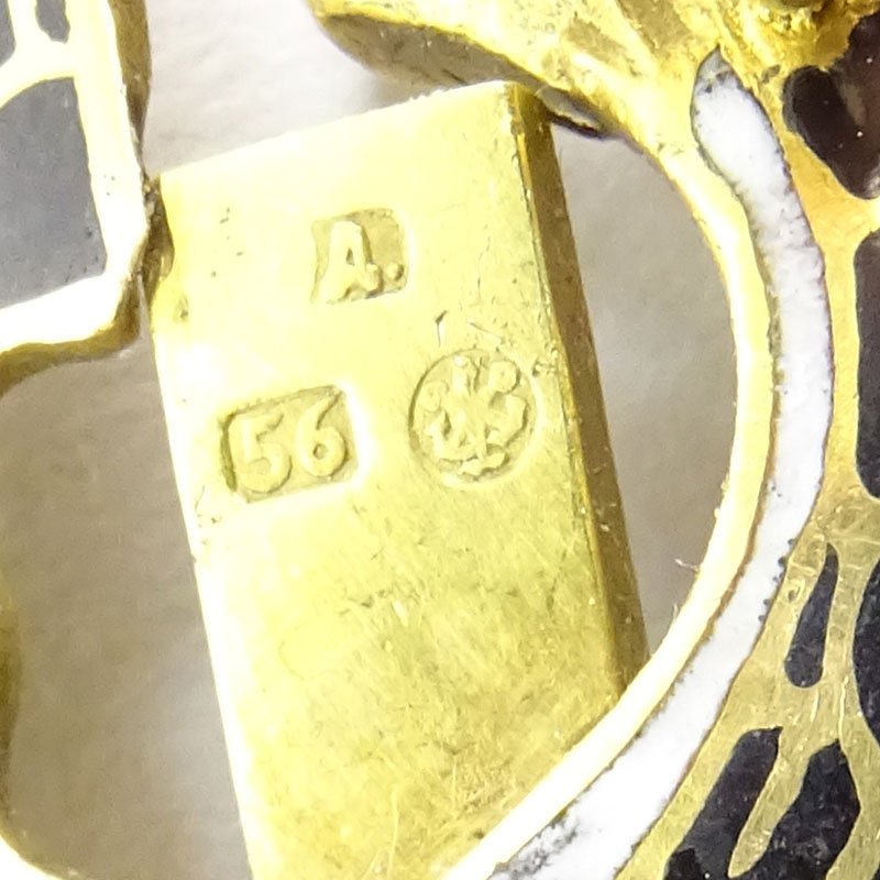

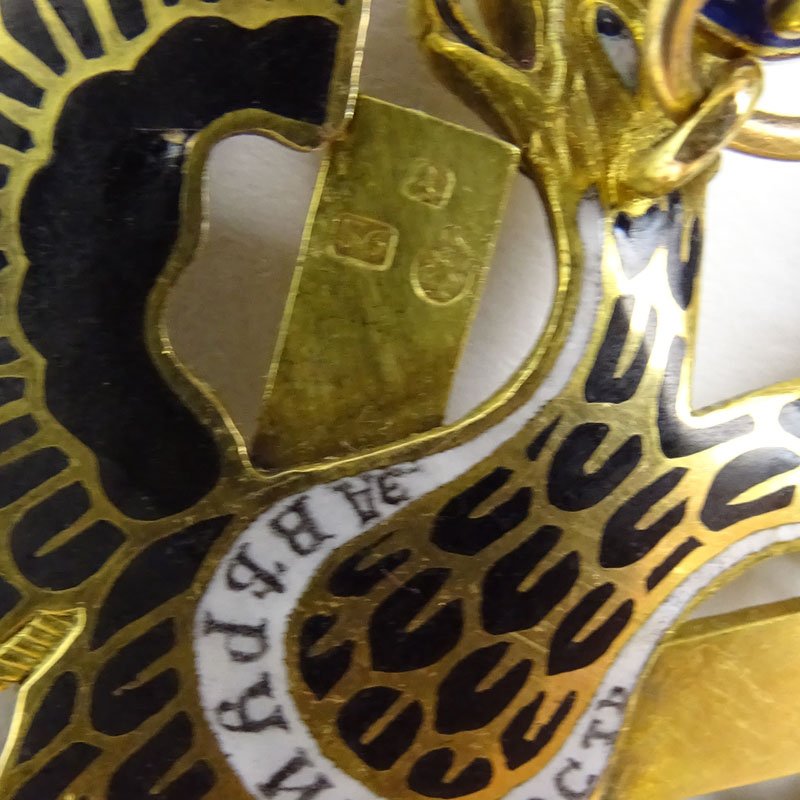

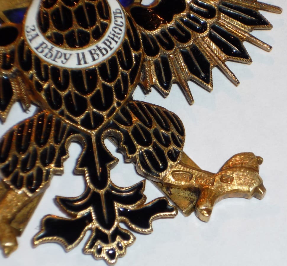

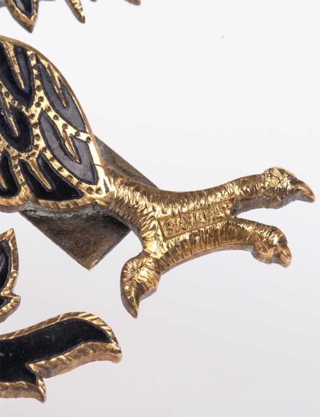

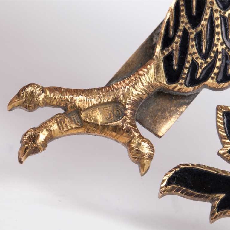

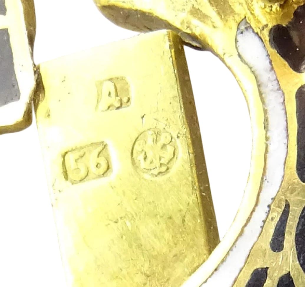

Fake marks.

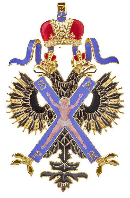

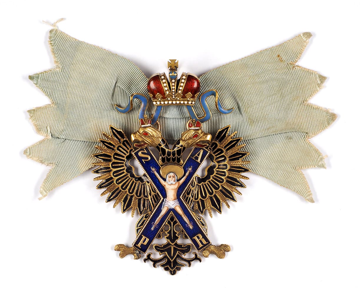

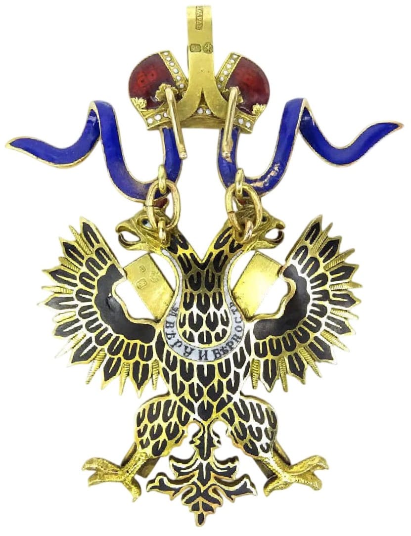

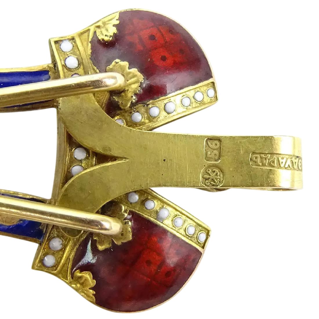

Another variation of fake "Eduard" badges.
Gold.
Measures 88,9 х 69,8.
Weight 60 g.
Fake marks.

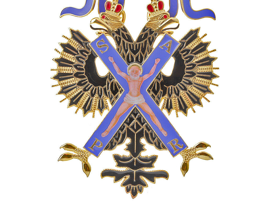

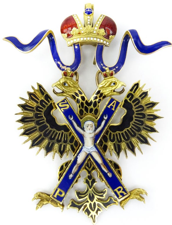

Another creature from "Eduard".
Naïve fake à la Eduard.

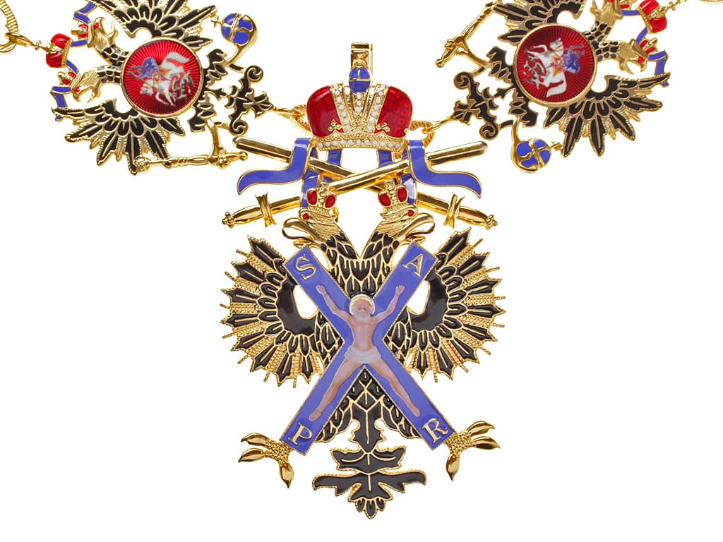

Version with swords.

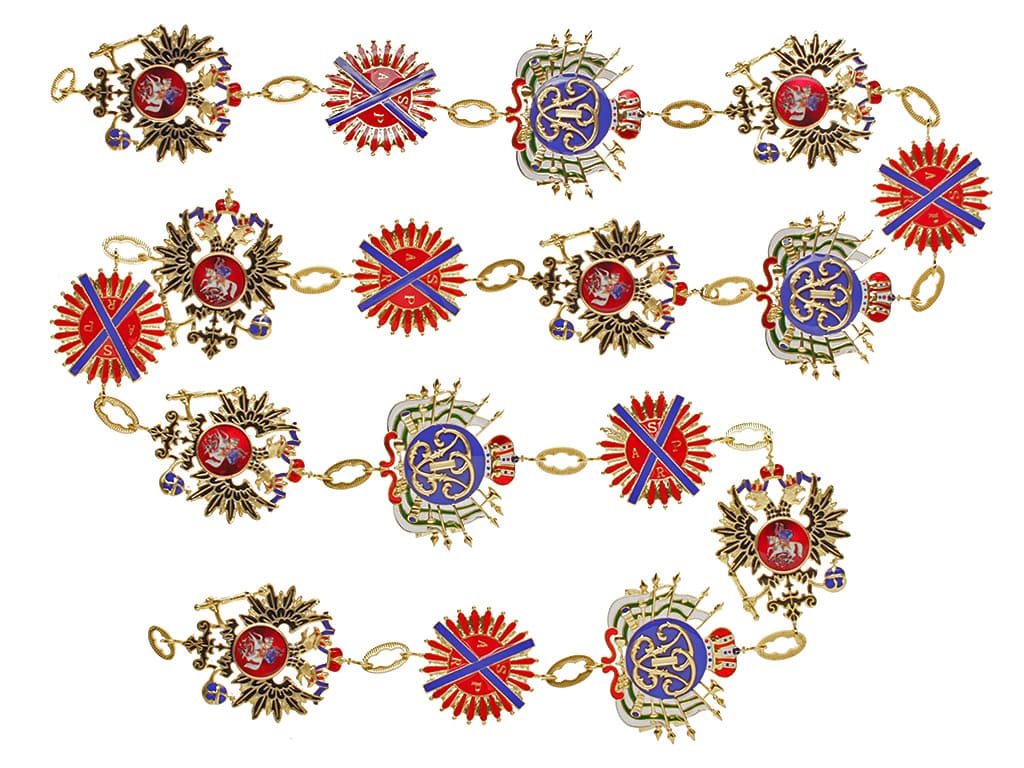

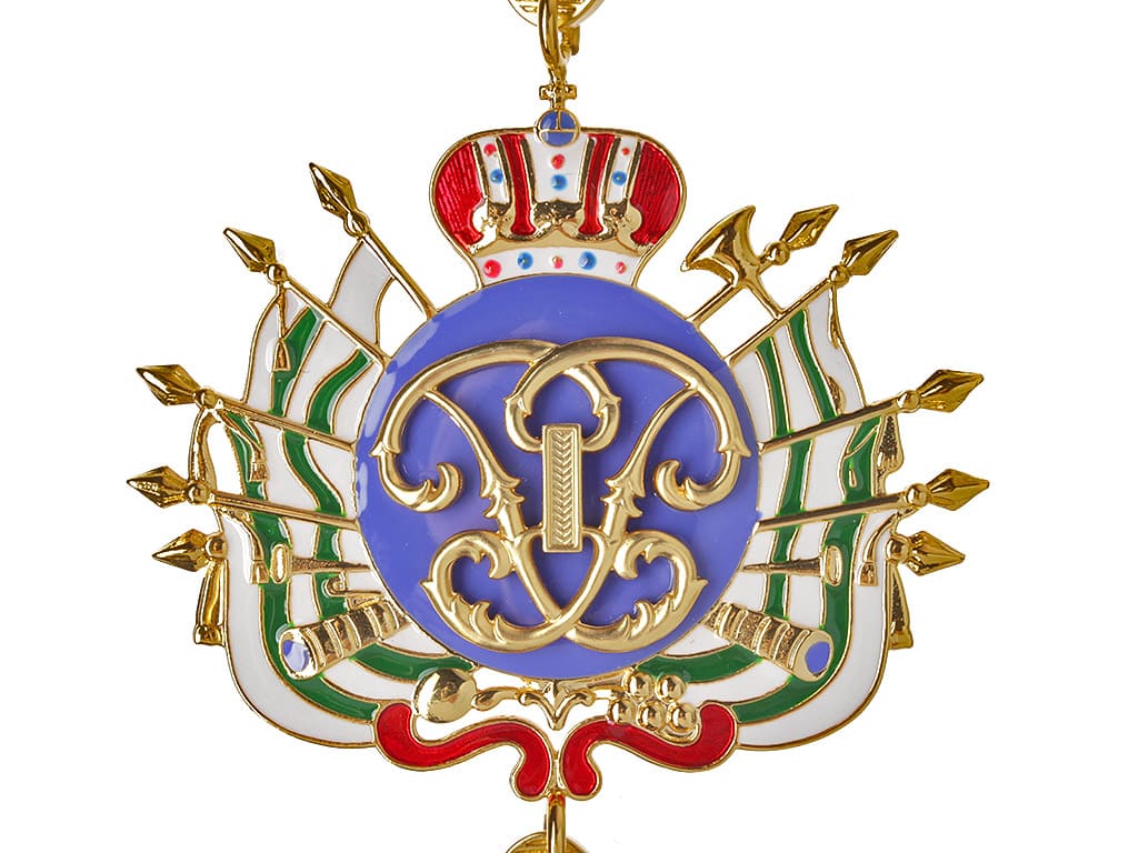

Collar.

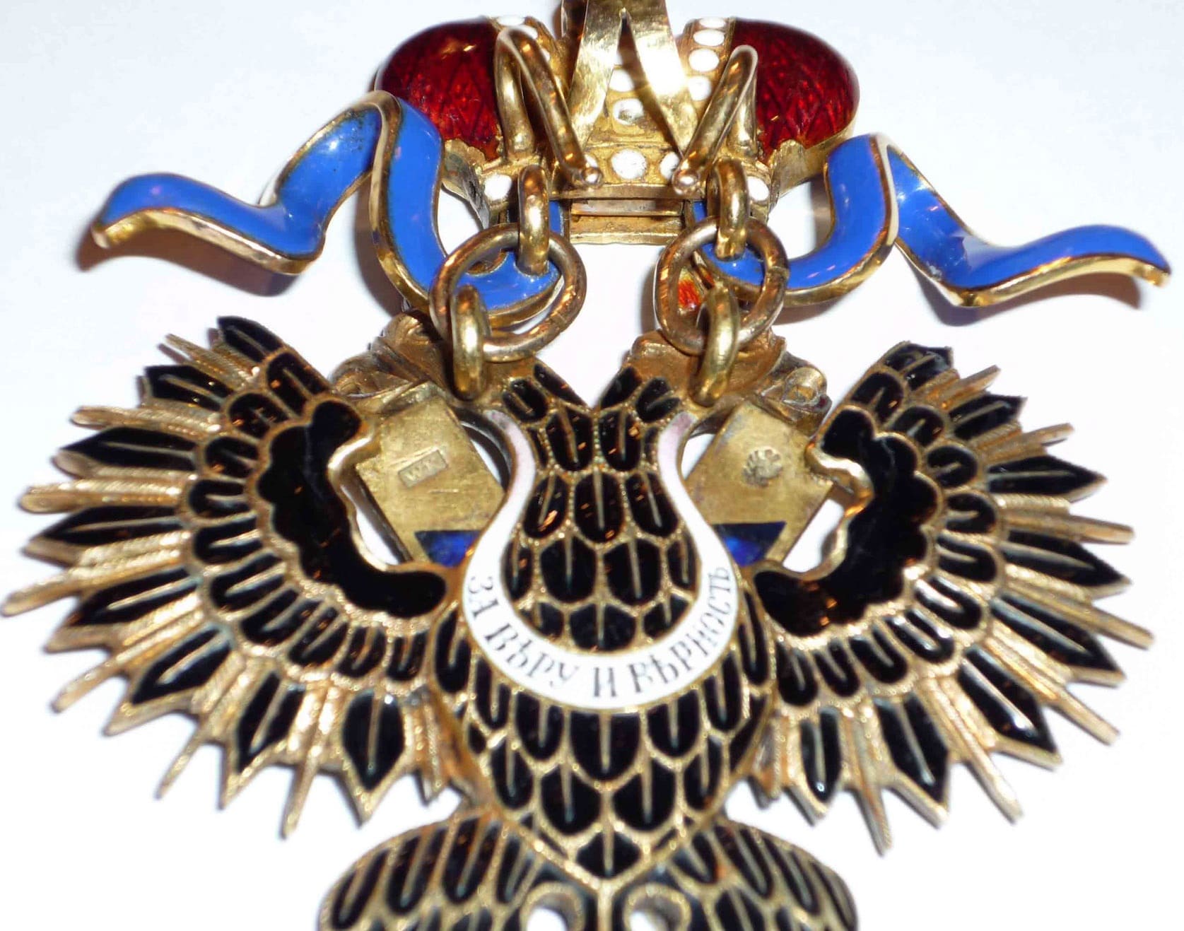

Fake "WK" badge.
Fake marks.

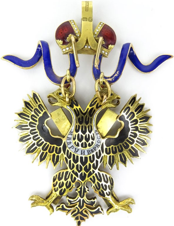

"Eduard-made set from 1880s"

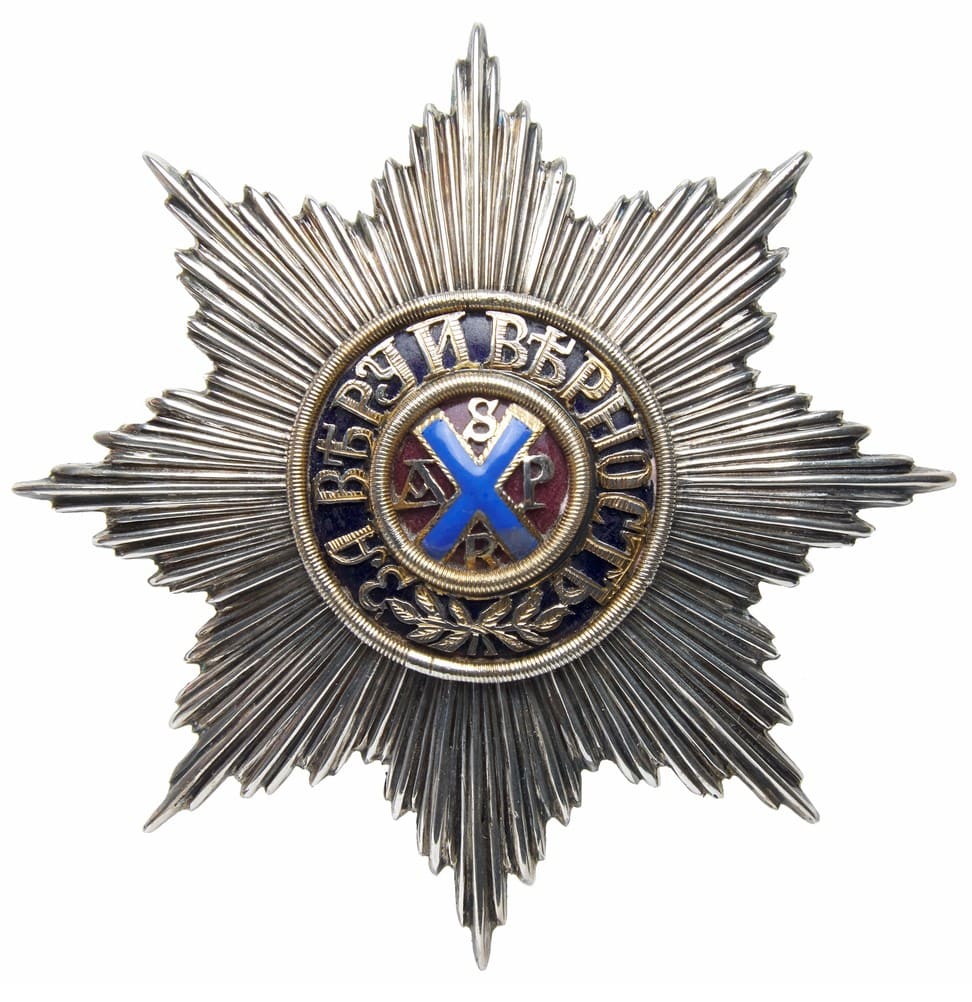

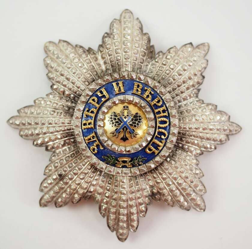

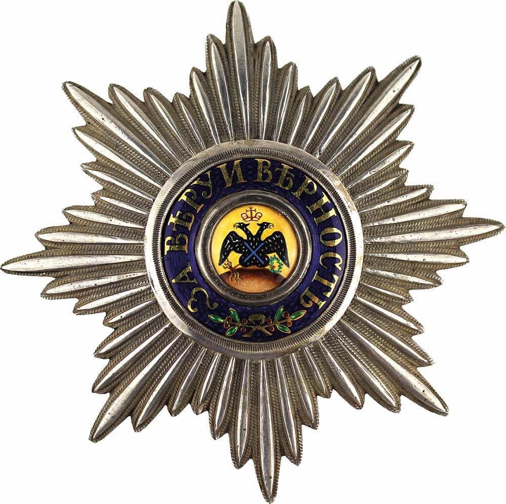

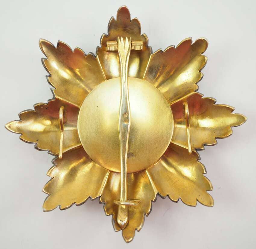

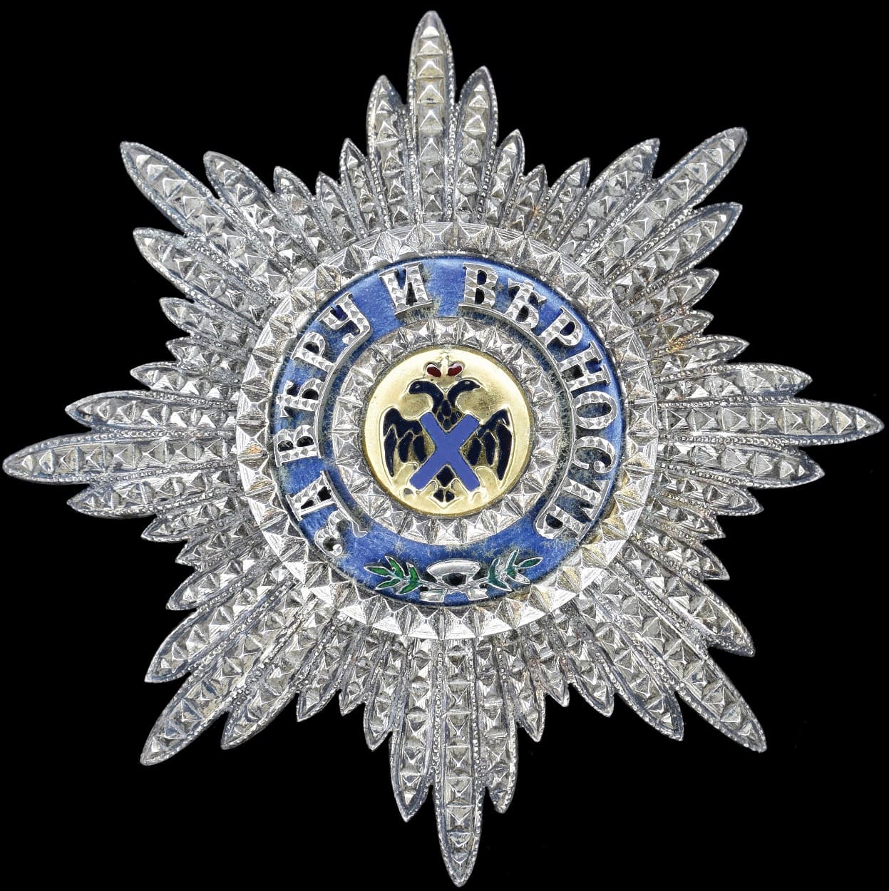

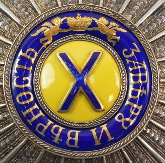

Breast star (perfect match for the cross).

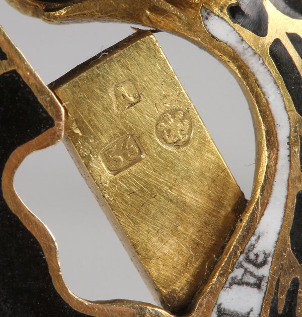

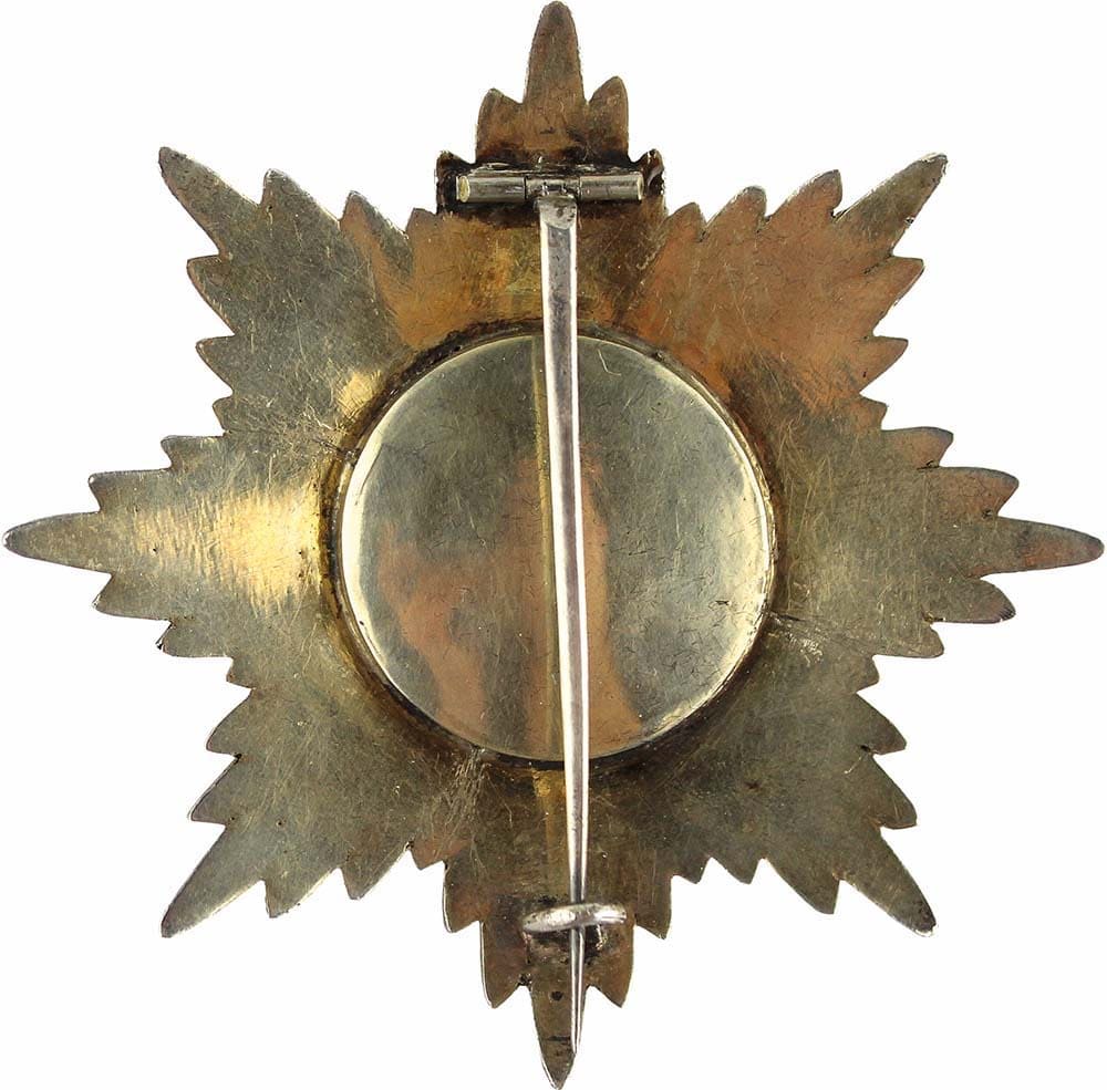

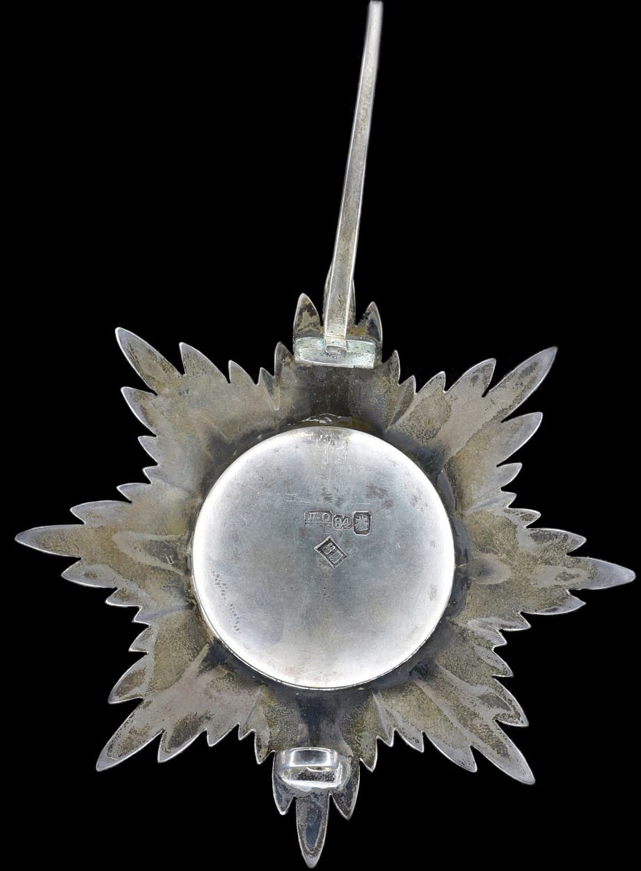

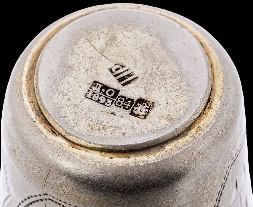

Silver hallmarks of Moscow assay office are original. No wonder, fakers used the original bottom of the silver goblet as a back plate.
A similar goblet was used to create our "masterpiece".

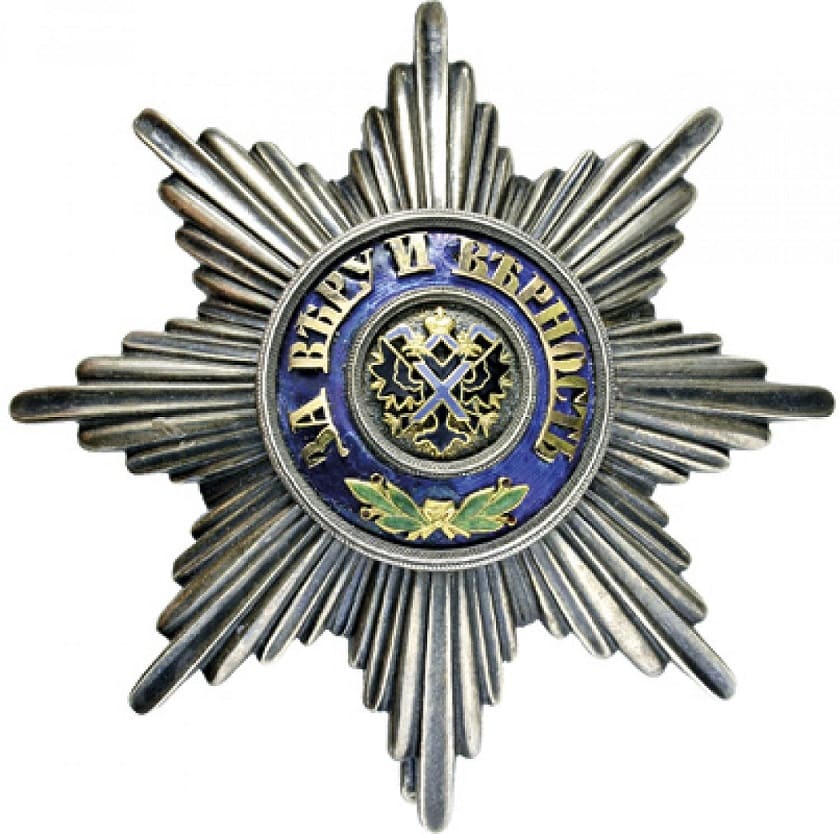

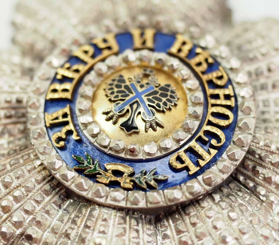

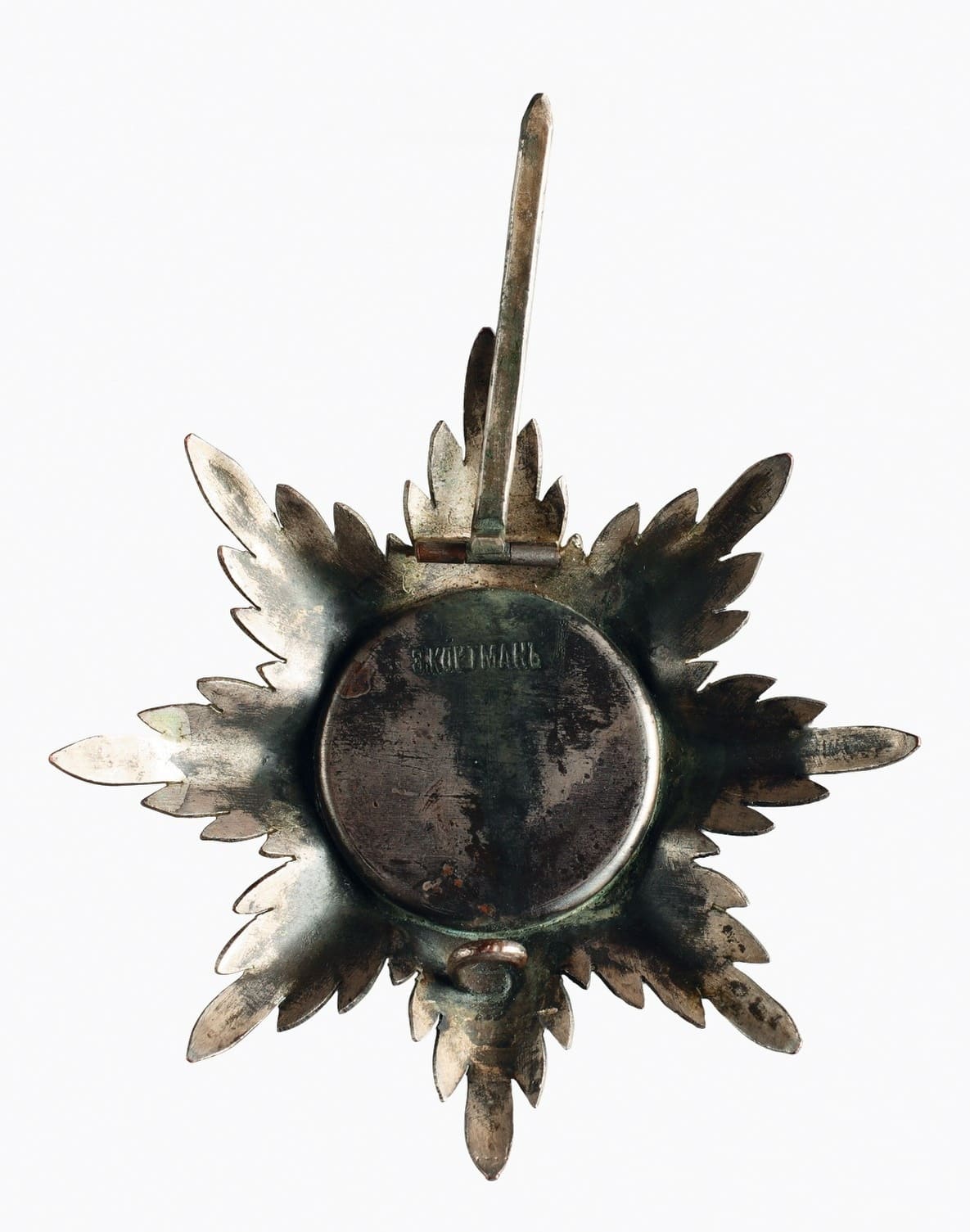

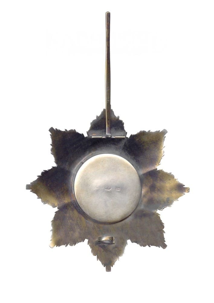

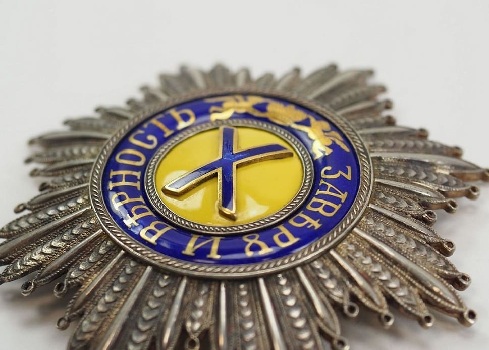

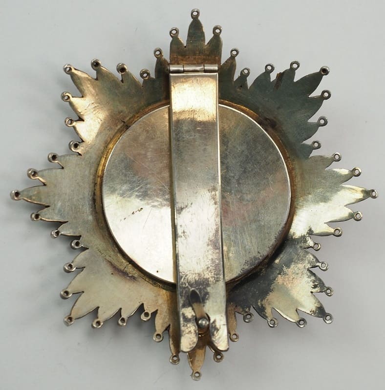

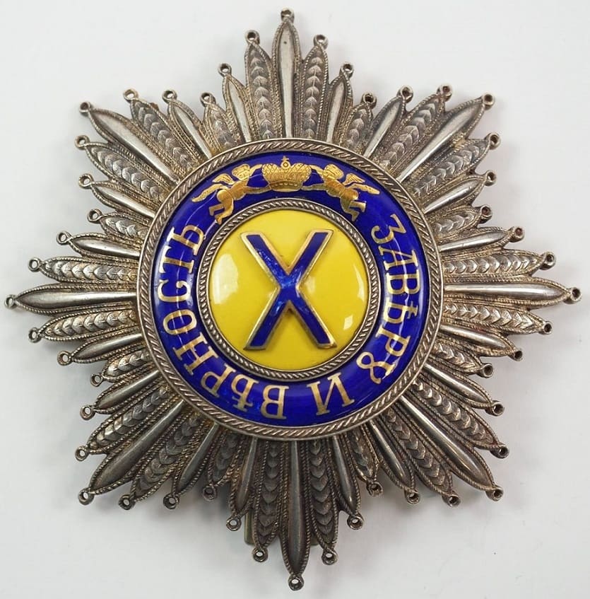

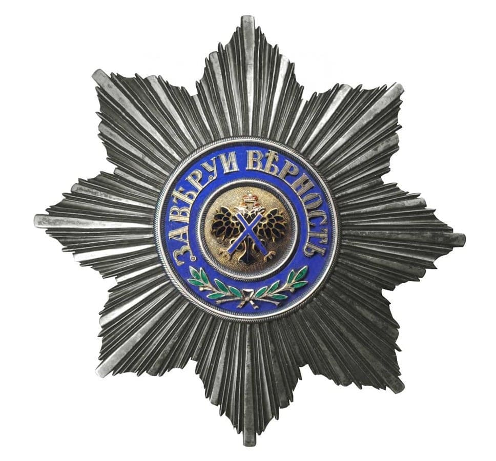

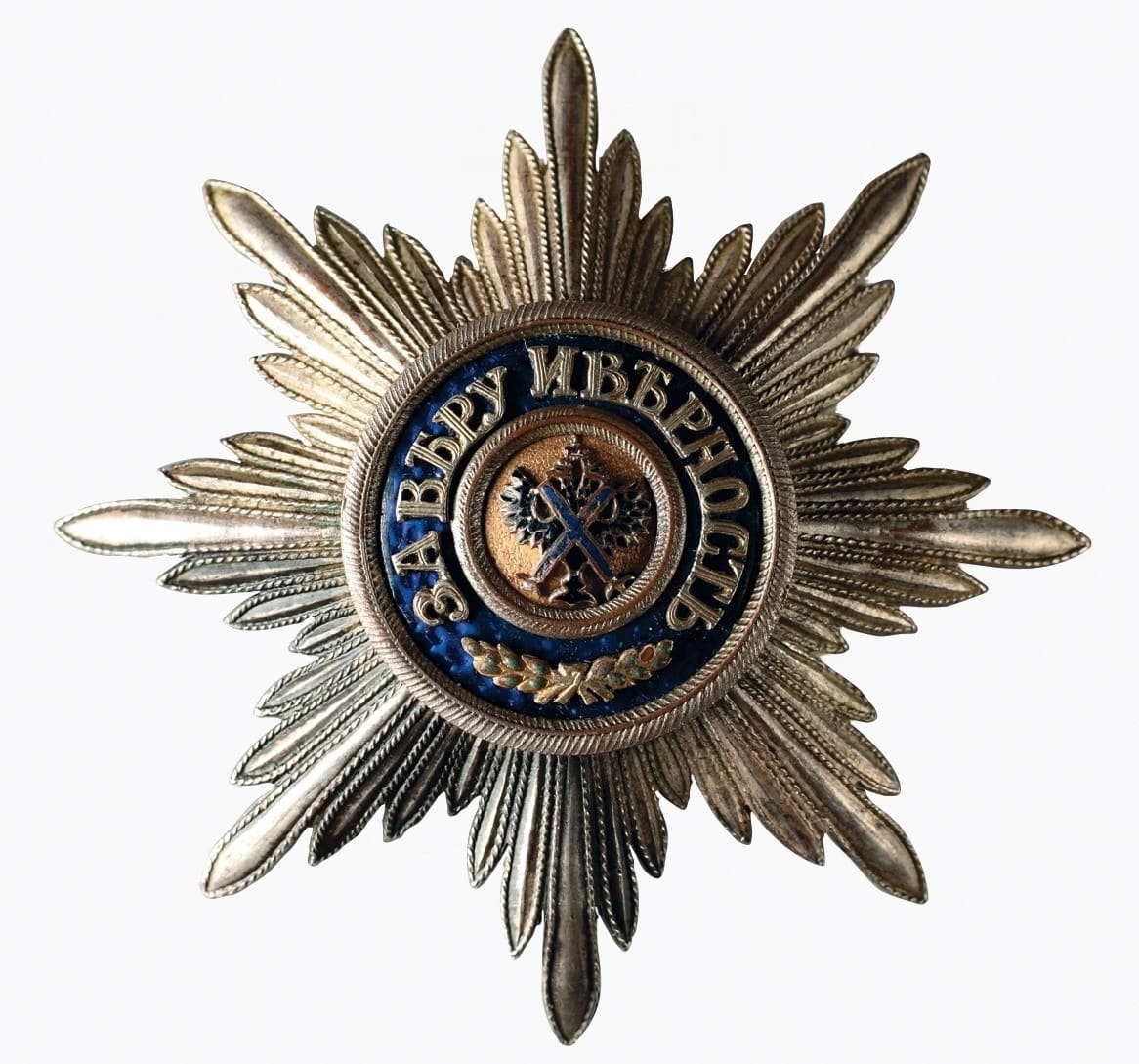

"Classical" pseudo-Kortman fake breast star of Saint Andrew order from 1990s.
White metal, enamel.
Size 93 x 90 mm.
Weight 55.3 g.
Fake mark "E.Kortman/Э.Кортманъ".

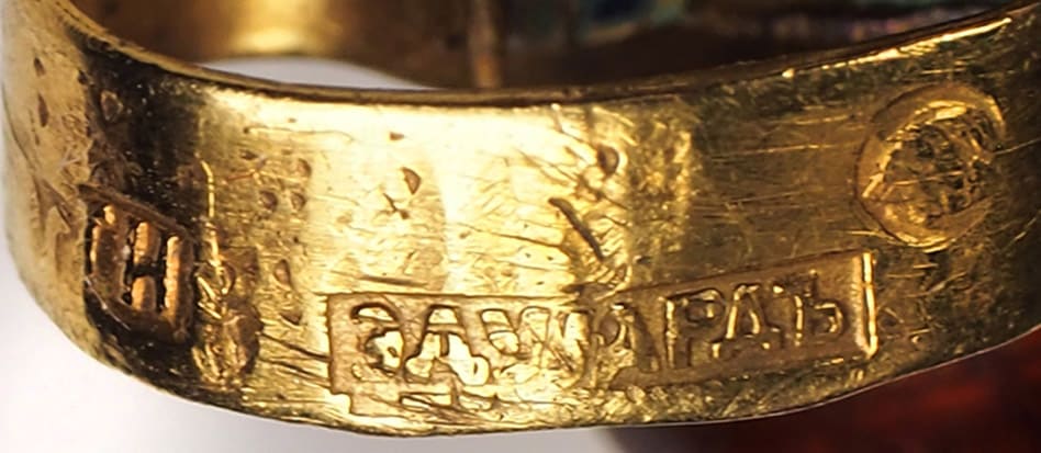

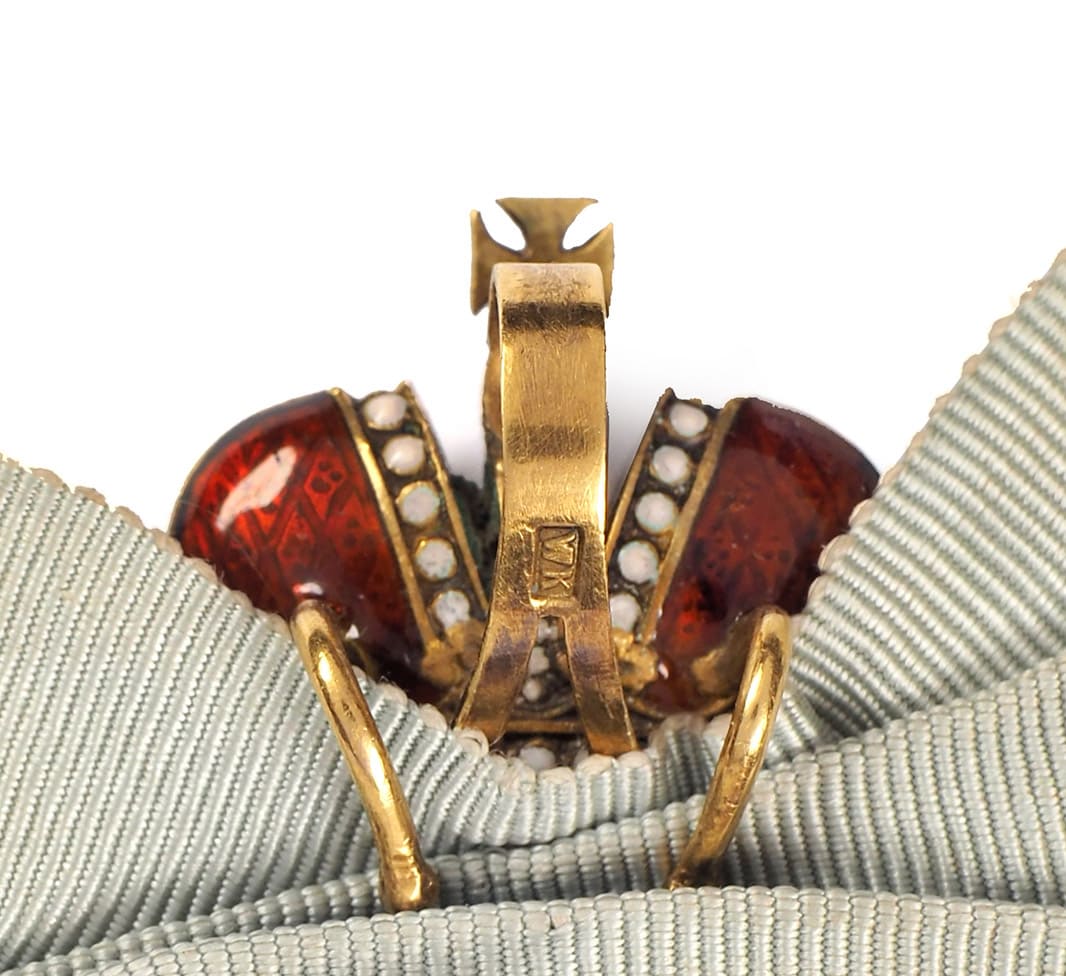

Marked with fake "WK" mark for Johann Wilhelm Keibel workshop.

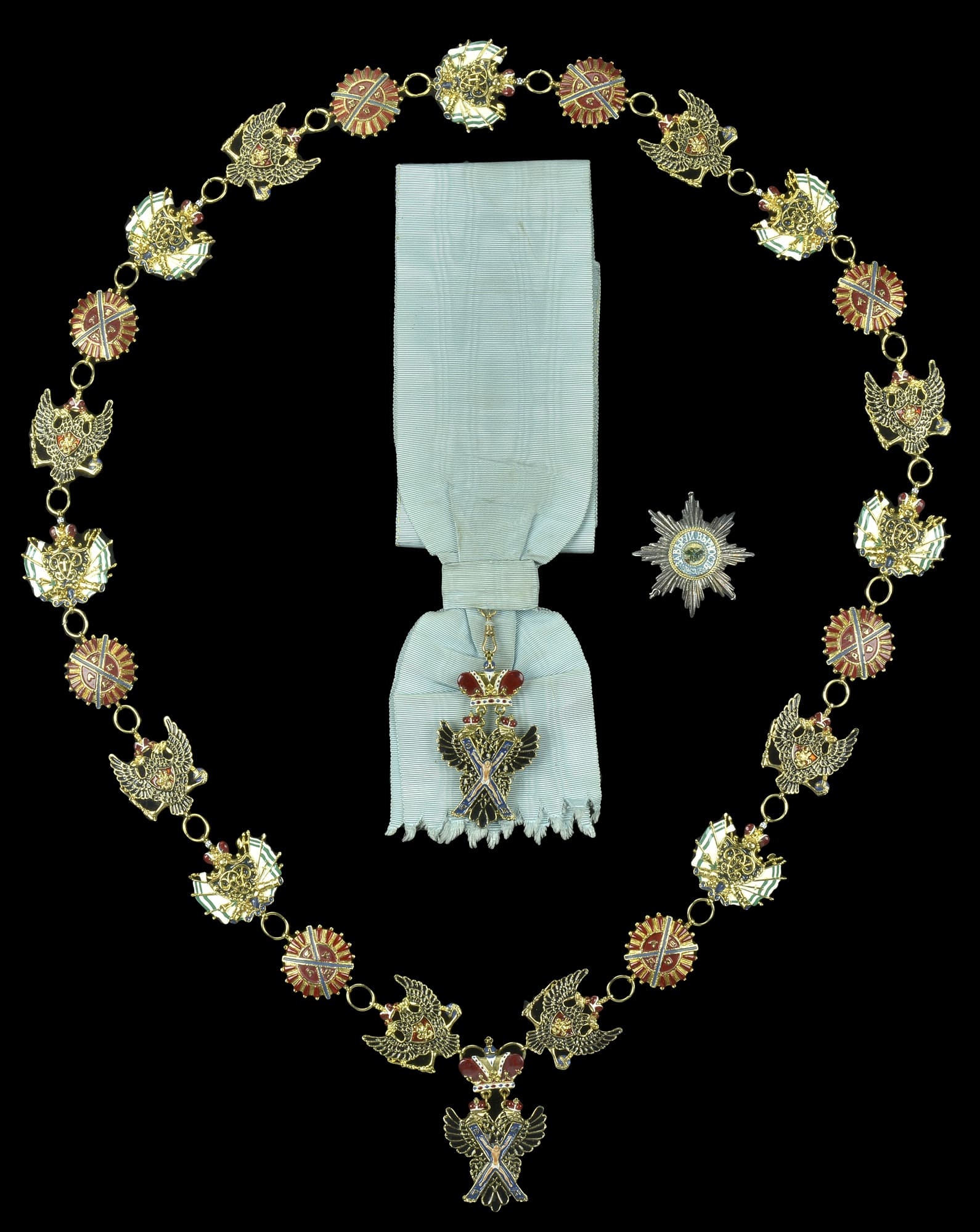

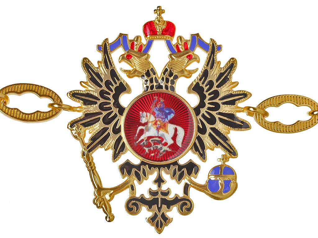

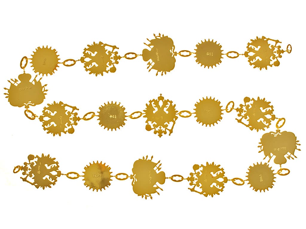

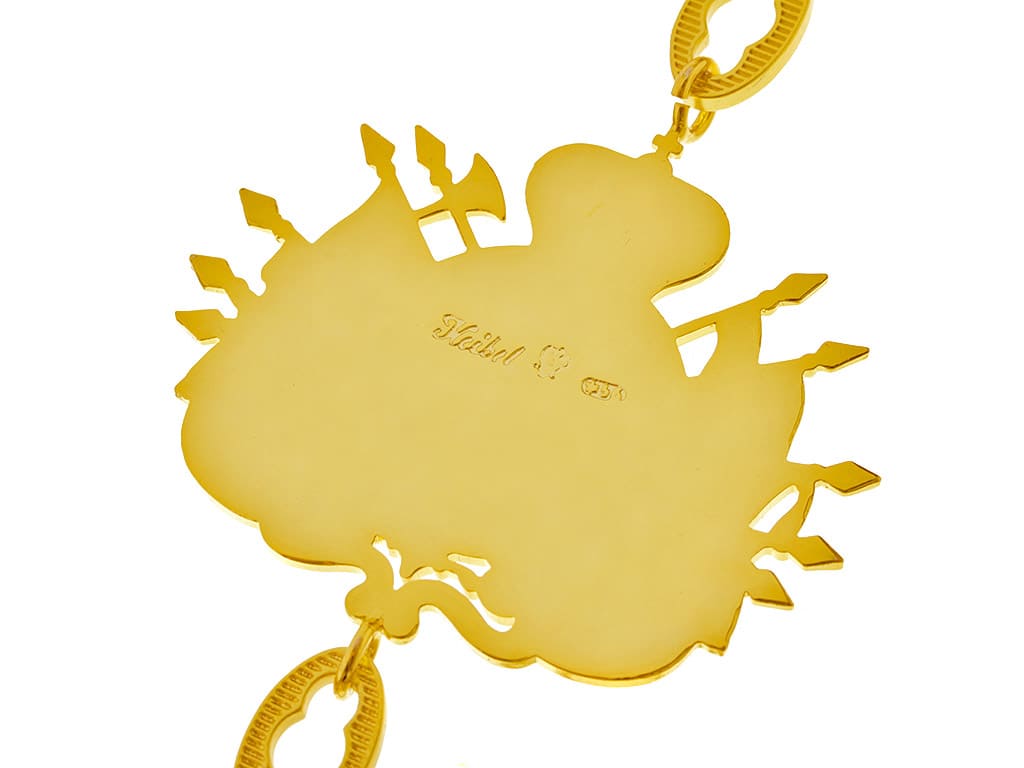

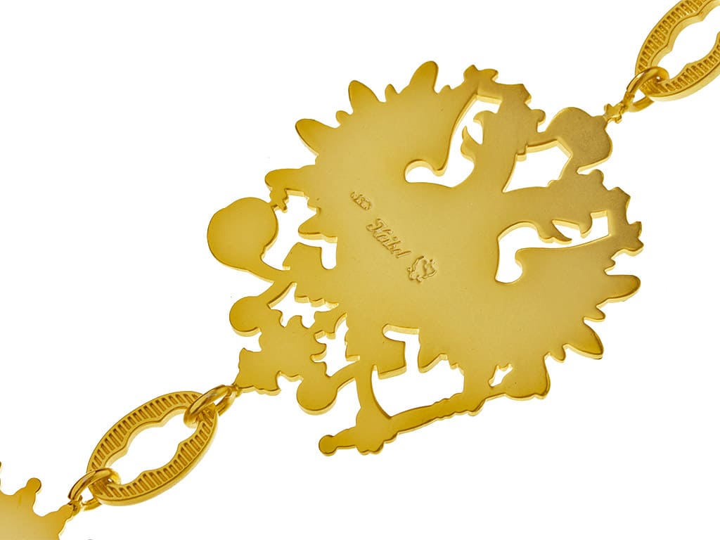

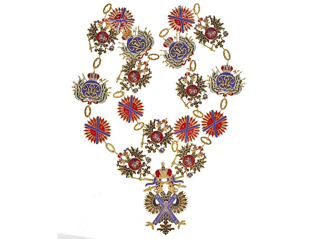

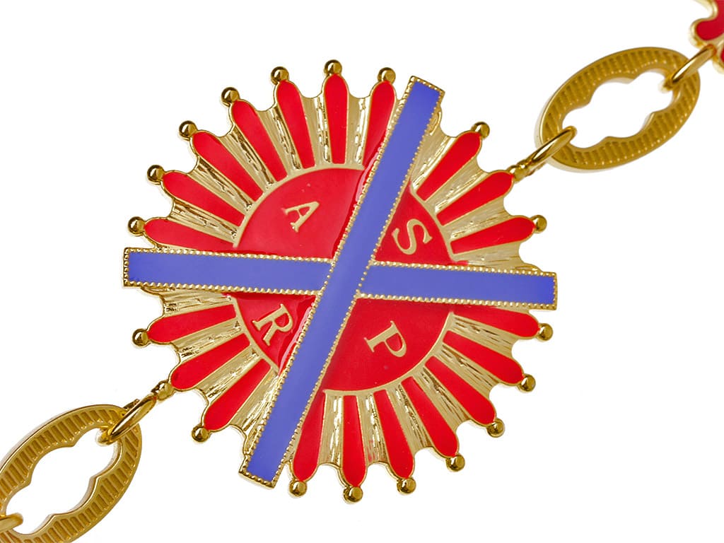

Fake link of Saint Andrew order collar .
54 x 44 mm.

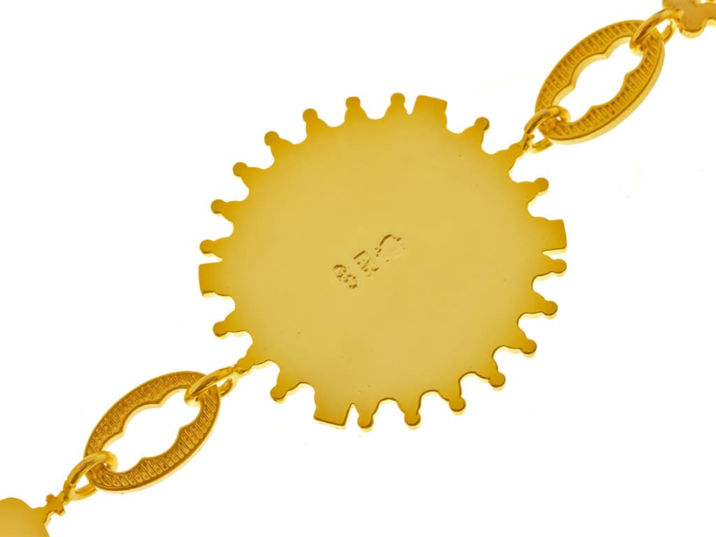

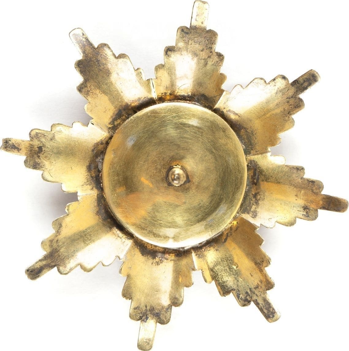

Fake from circa late 1990s/early 2000s.

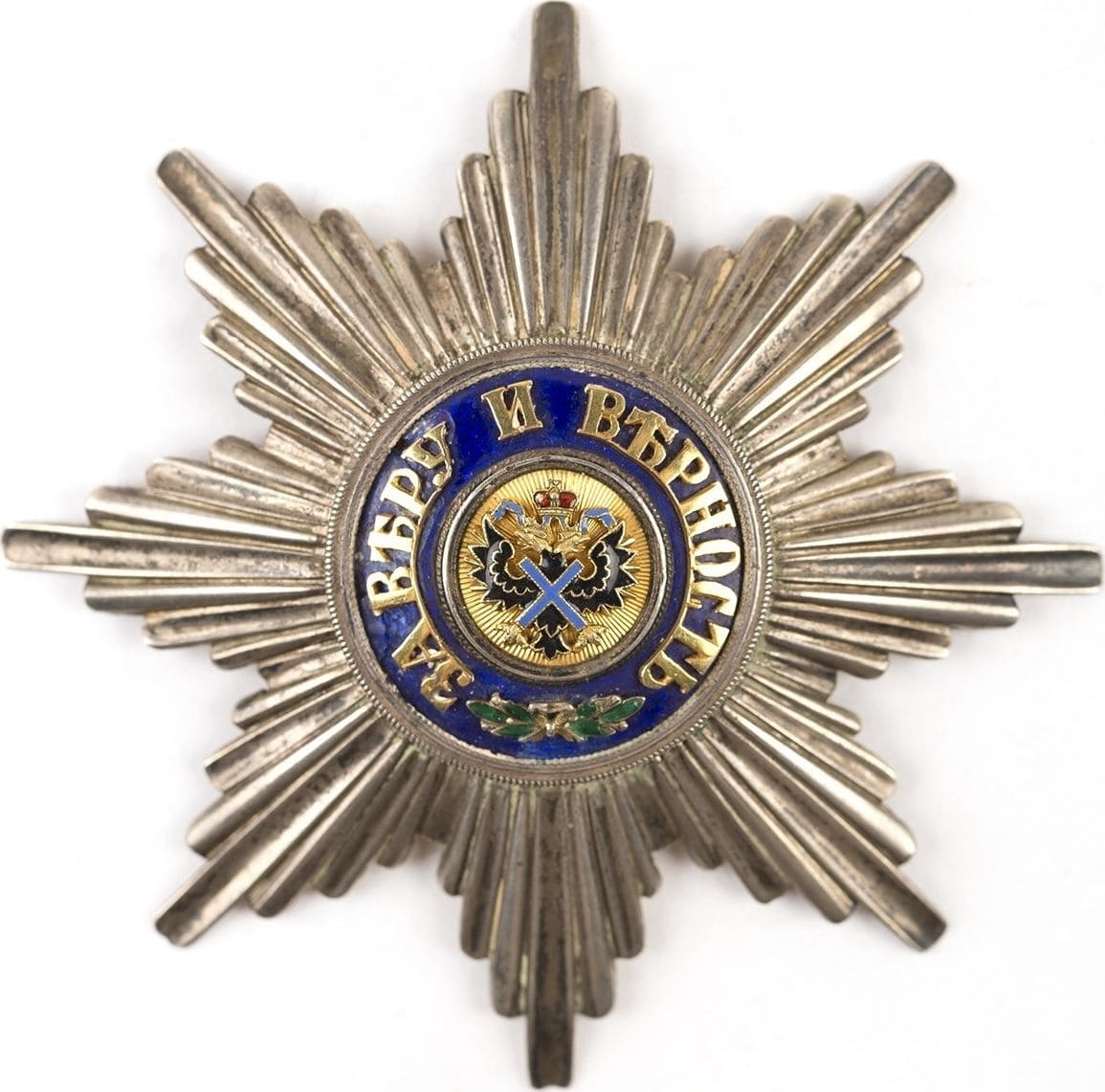

Size 85 х 85 mm.
Weight 64.8 g.
Fake silver hallmark "84" and phantasy maker's mark "WN".

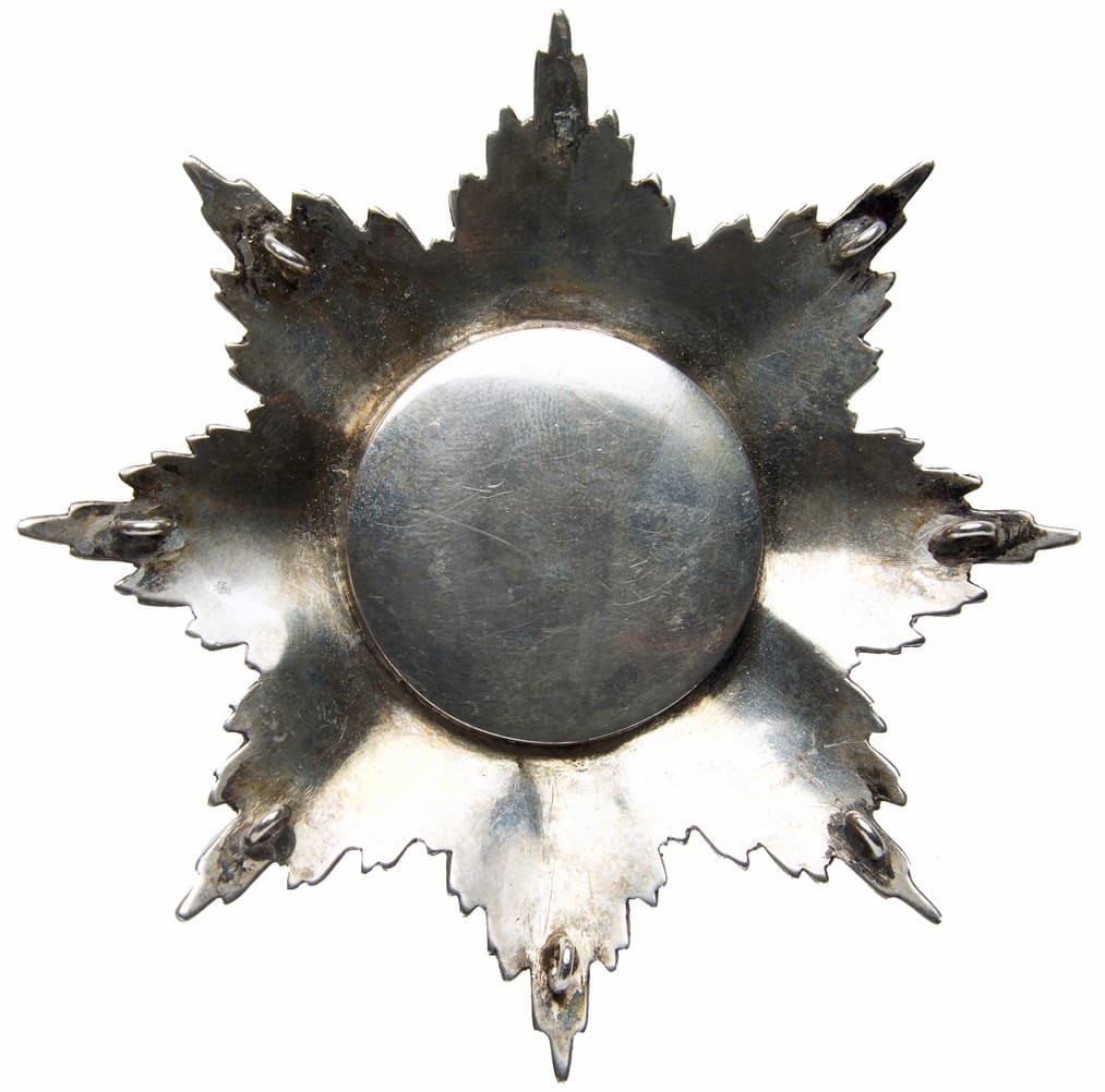

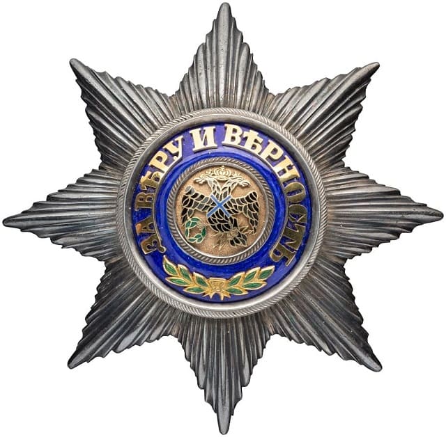

Another fake breast star of Saint Andrew order.
Size 90.3 mm.
Weight 64.8 g.
Unmarked.

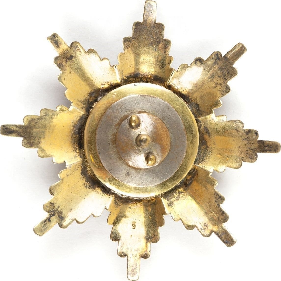

Silver, gold, gilt, enamel.
Size 80 mm.
Weight 47.62 g.
Marked with mysterious mark "5".

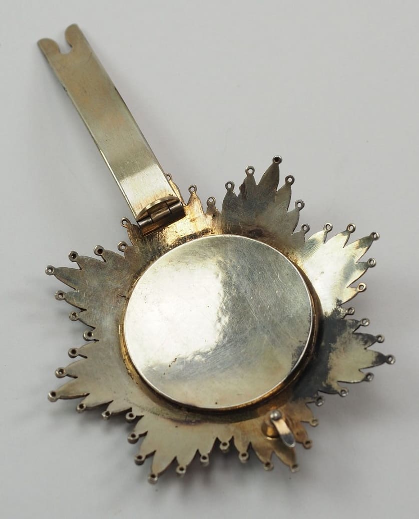

Interesting fake breast star of Saint Andrew order.

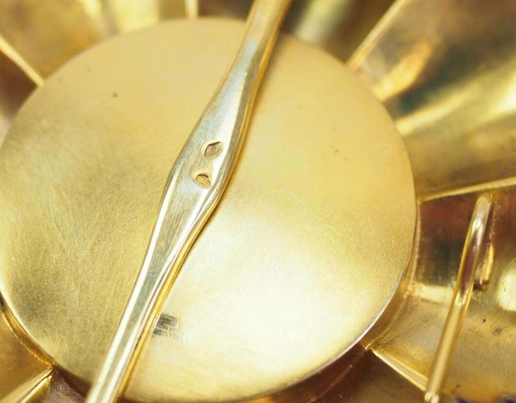

Original French-made breast star with added fake central medallion of Saint Andrew order.
Size 86 x 86 mm.
Weight 94.3 g.
French-made breast star with added fake central medallion of Saint Andrew order.jpeg
Maker's mark unreadable. Most likely Arthus Bertrand or Chobillion.

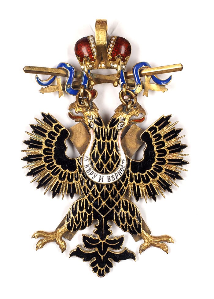

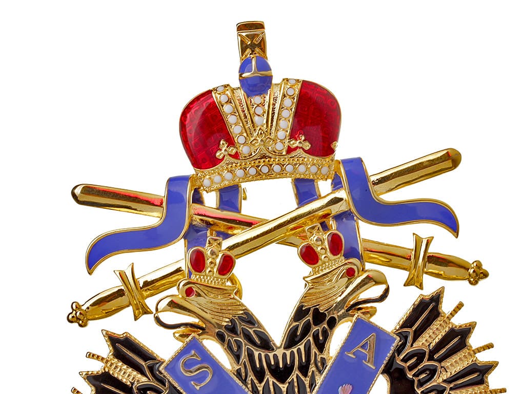

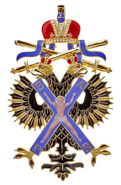

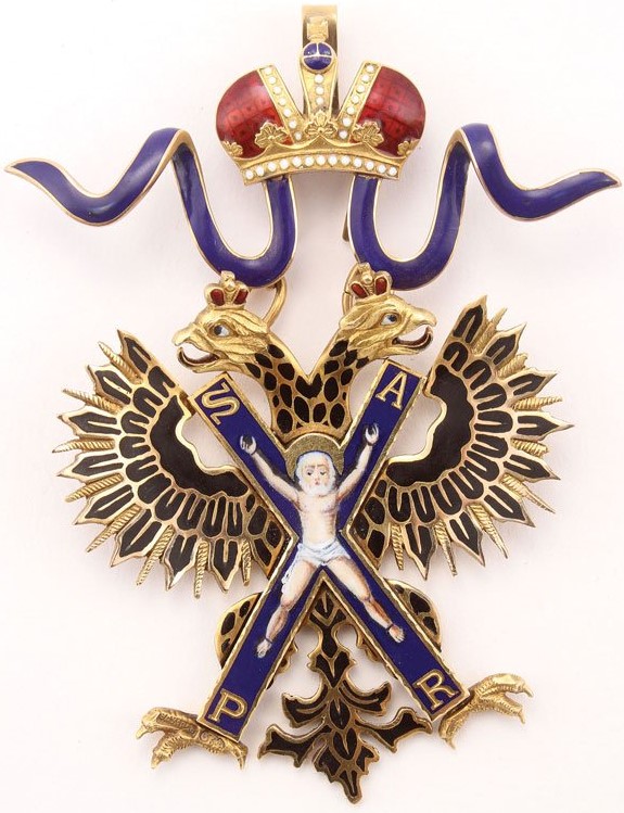

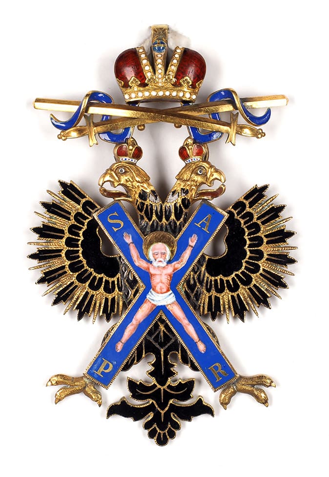

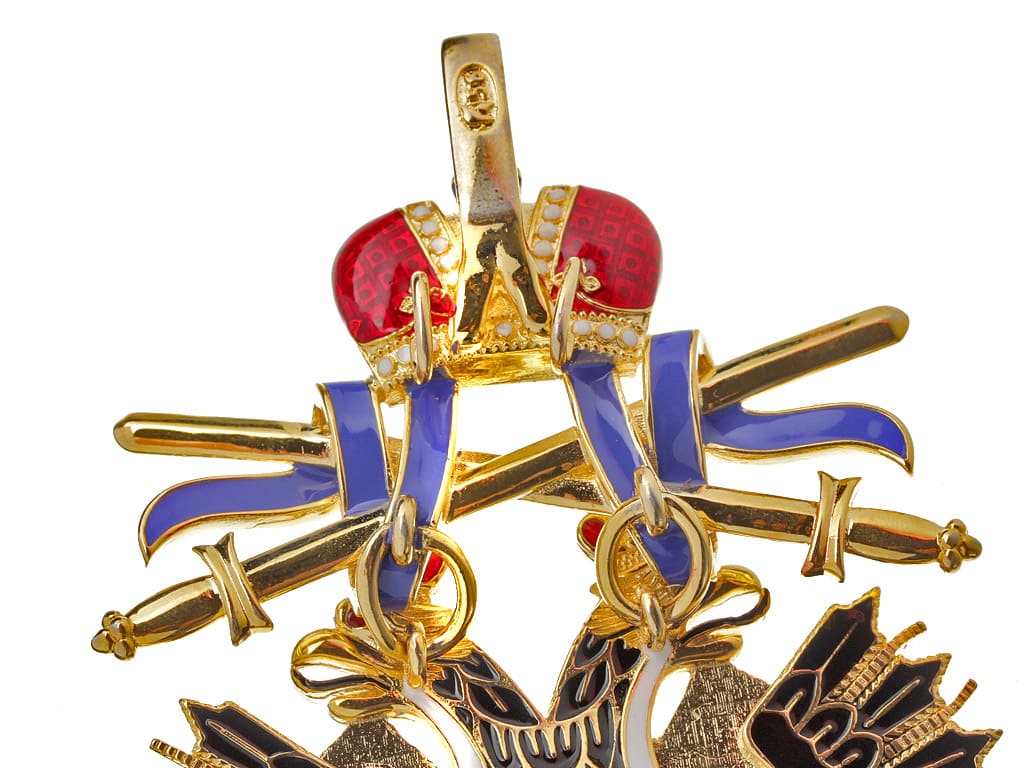

Another fake Saint Andrew order (this time with swords and "made by Eduard") with authenticity certificate from Mr.Levin /see above https://asiamedals.info/threads/fake-orders-of-st-andrew.23473/#post-360183/
Size 95×62 mm.
Weight 81.73 g.
Fake marks and phantasy maker's mark "TH".
Certificated.
