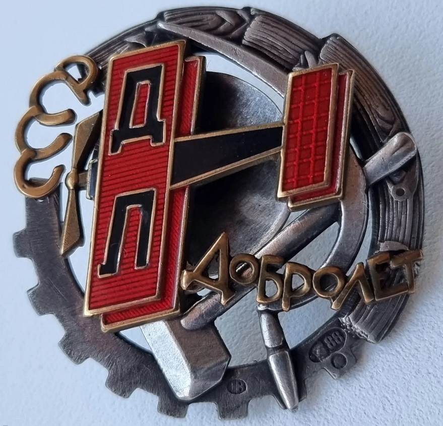

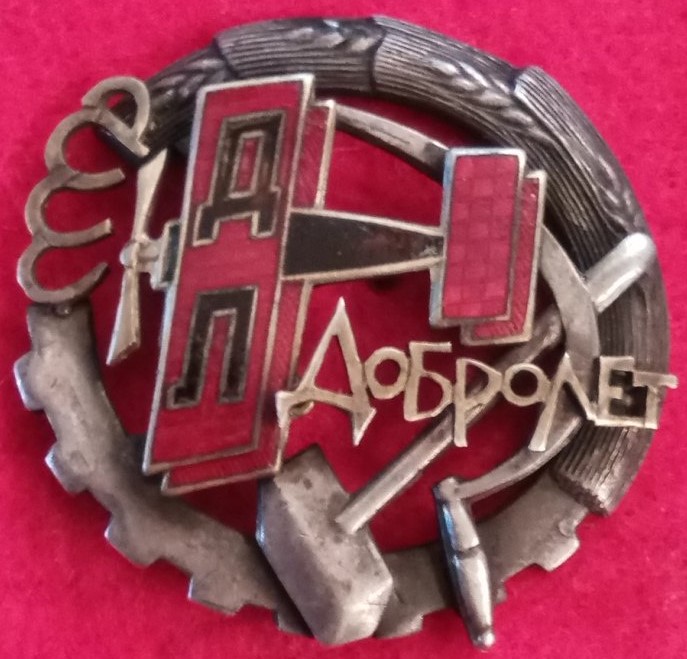

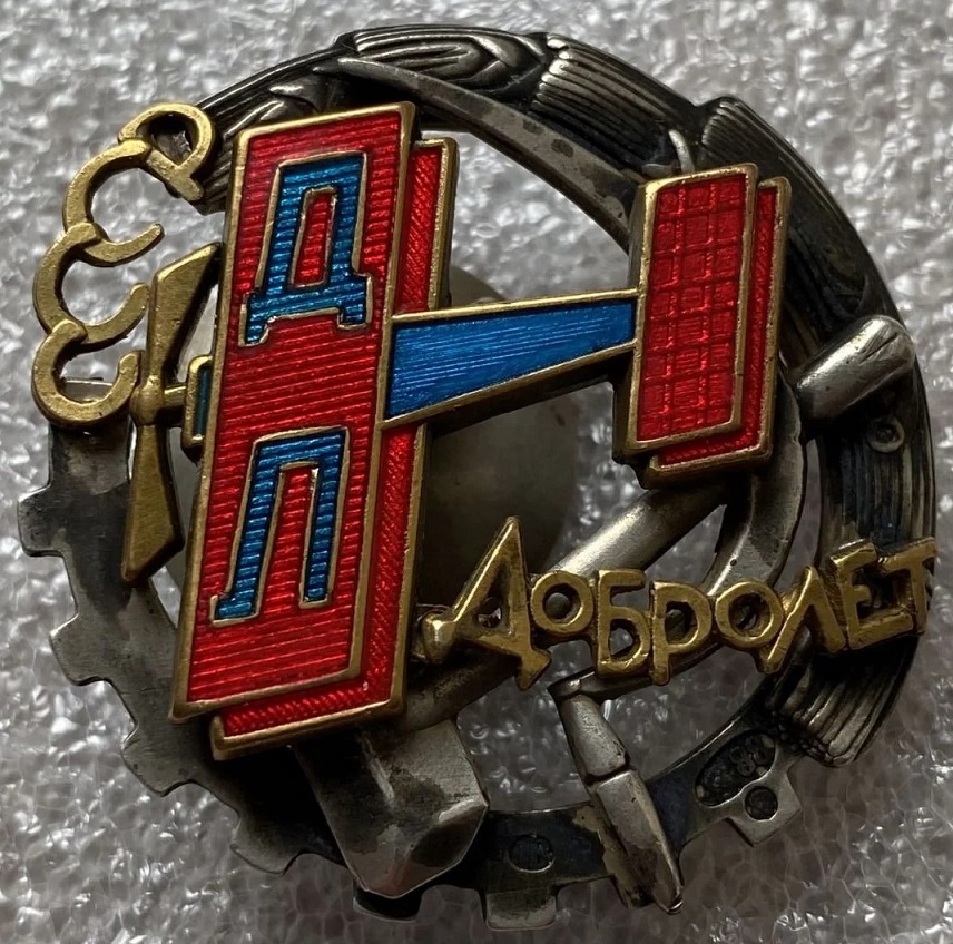

Award Badge of the Dobrolyot/Почётный жетон Добролёта (a.k.a. Наградной знак Добролёта)

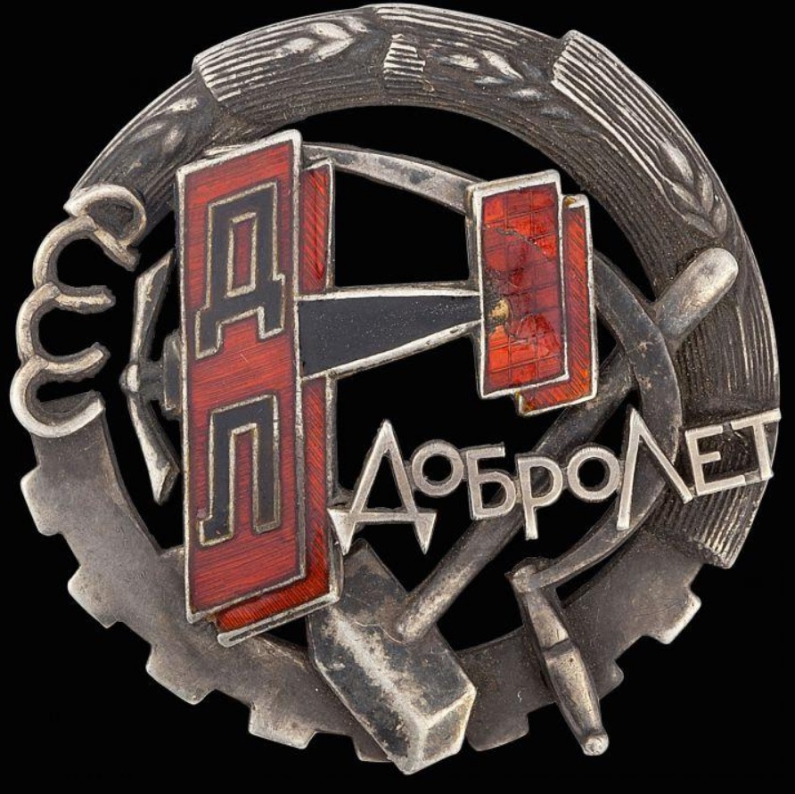

No. 6559

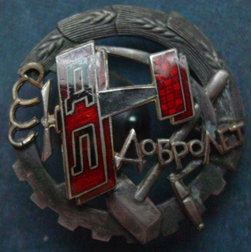

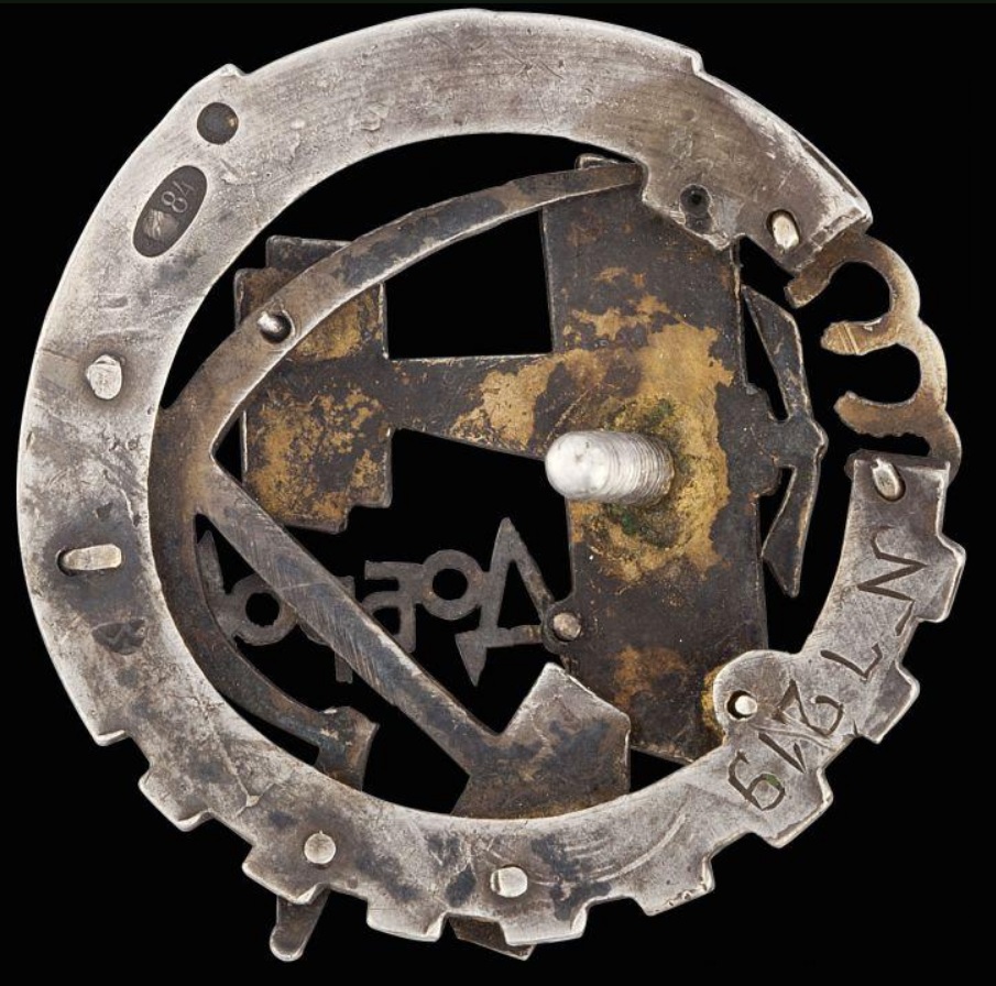

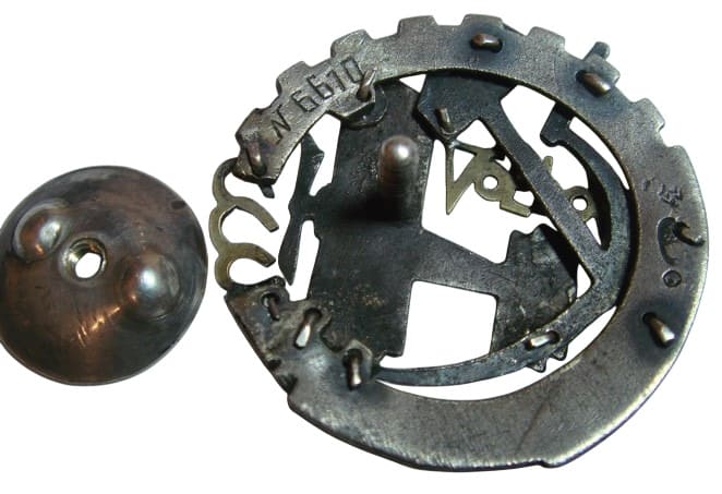

No. 7219
Size 37 mm.
Weight 13,24 g.

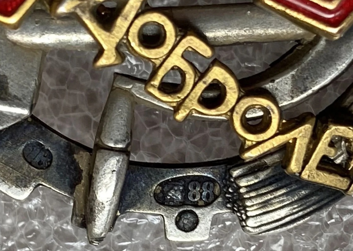

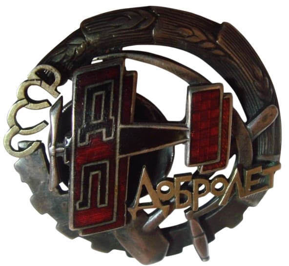

Badges with TM mark from first eight hundreds are also known.

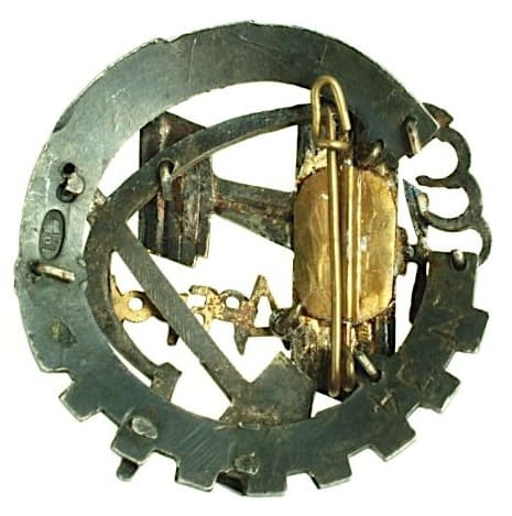

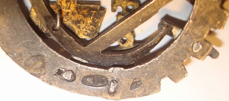

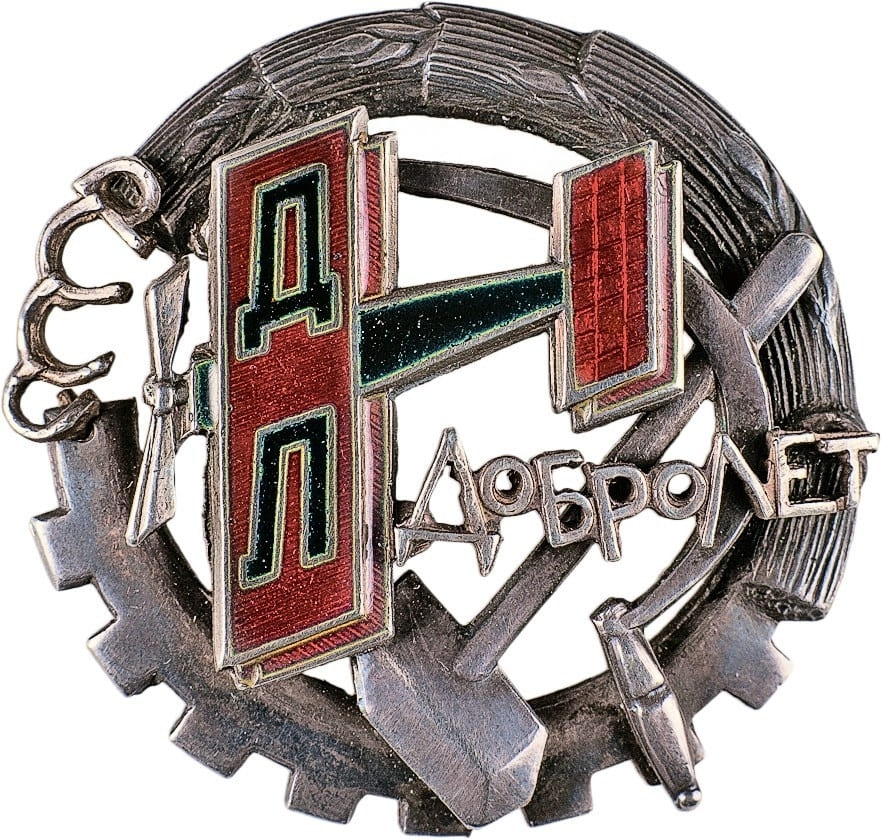

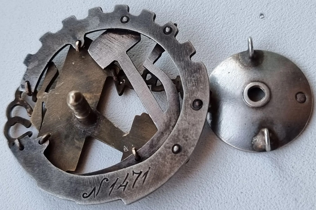

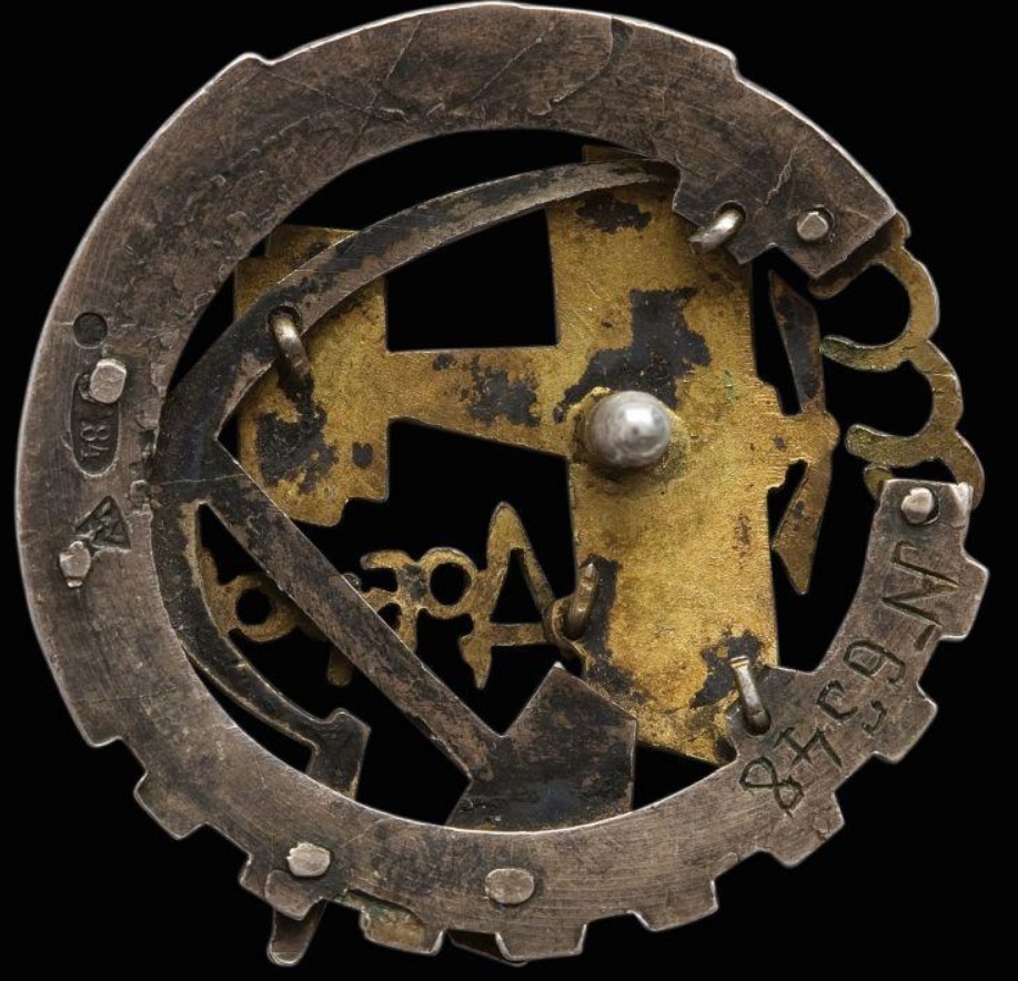

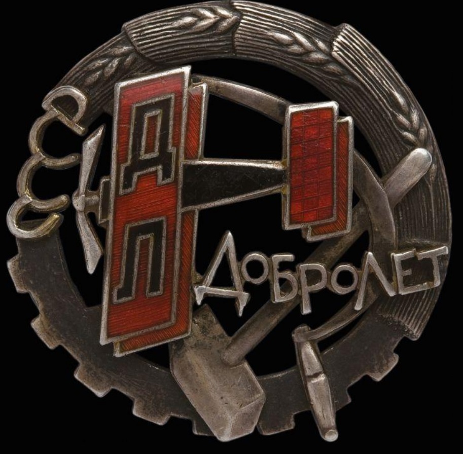

No.18
Silver, gilding, enamel.

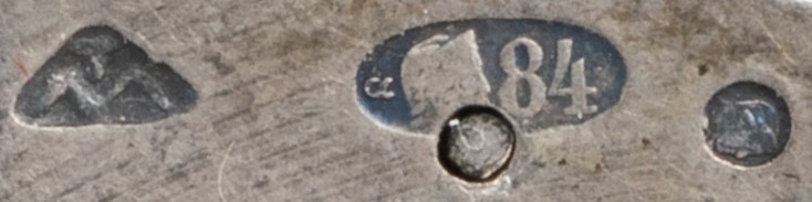

Marked with "TM" mark, Leningrad district assay office mark (alpha, female head in a kokoshnik to the right, 84) + round mark.
Size 36.5 × 36.7 mm.
Weight 15.03 g.

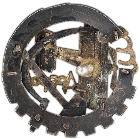

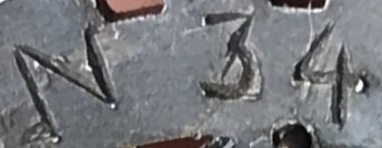

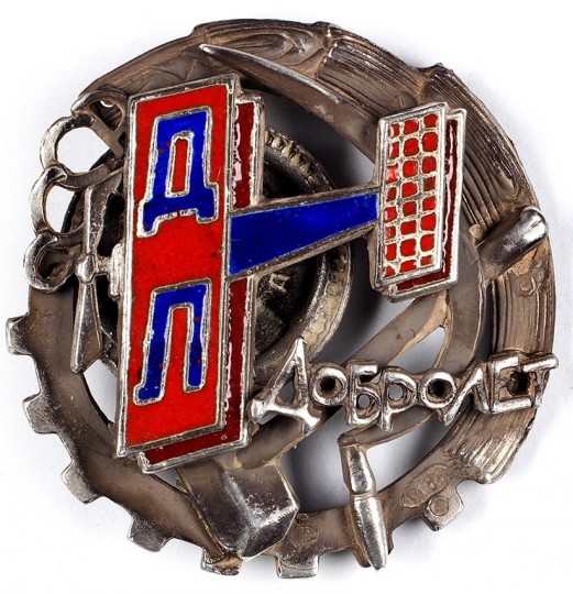

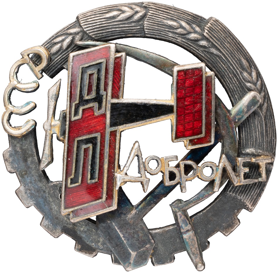

No.34
Size 36.9 х 37.0 mm.
Weight 14.92 g.

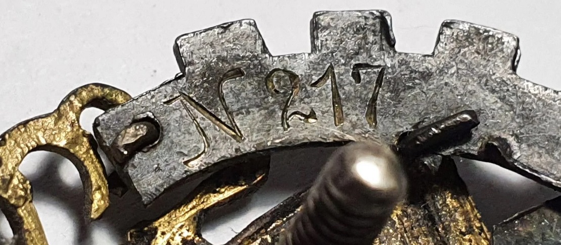

Engraved number.

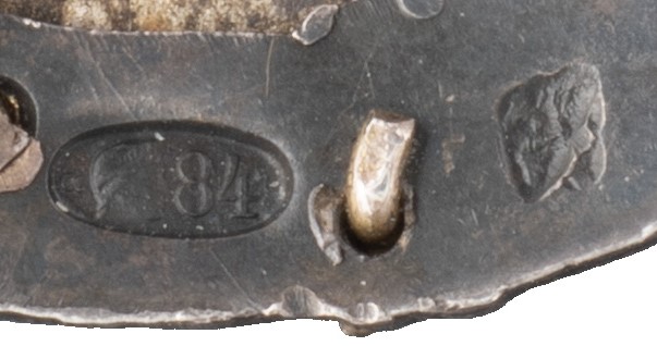

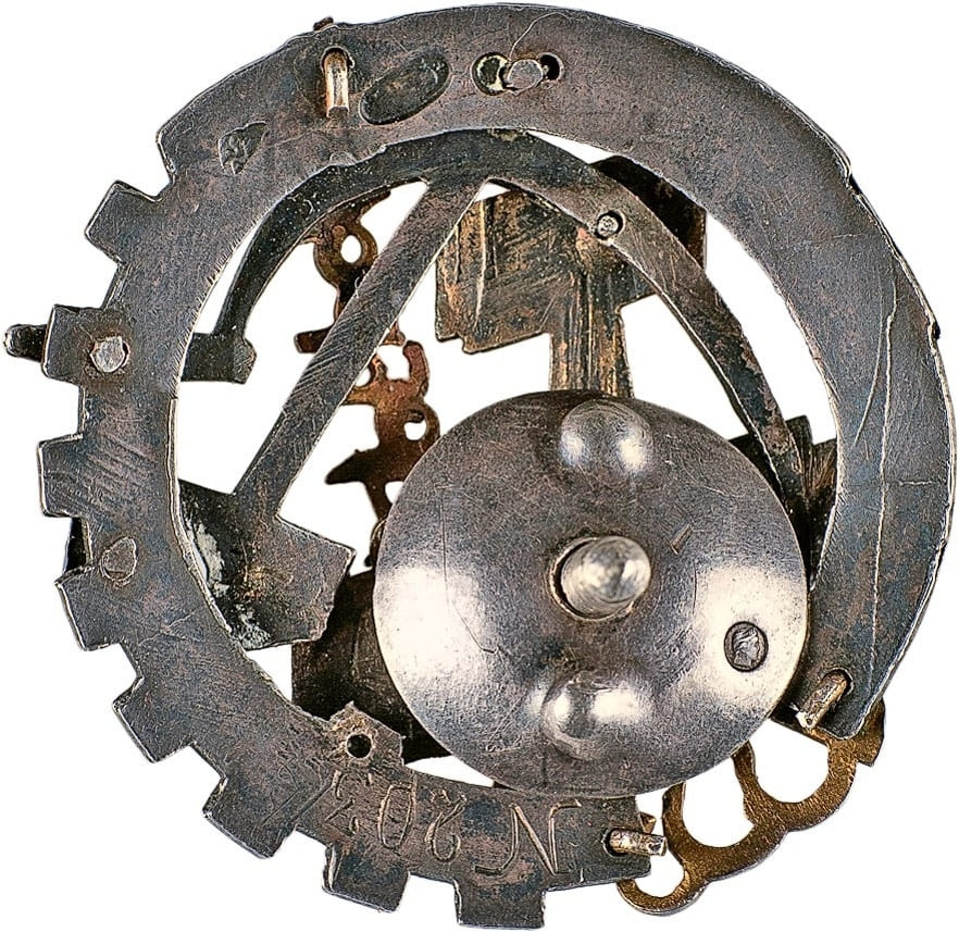

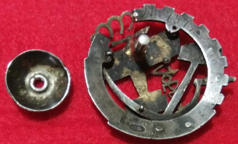

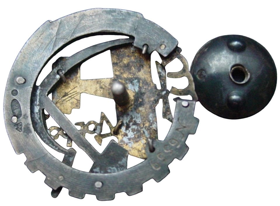

No. 133
Size 36.4 × 37 mm.
Weight 15.24 g.

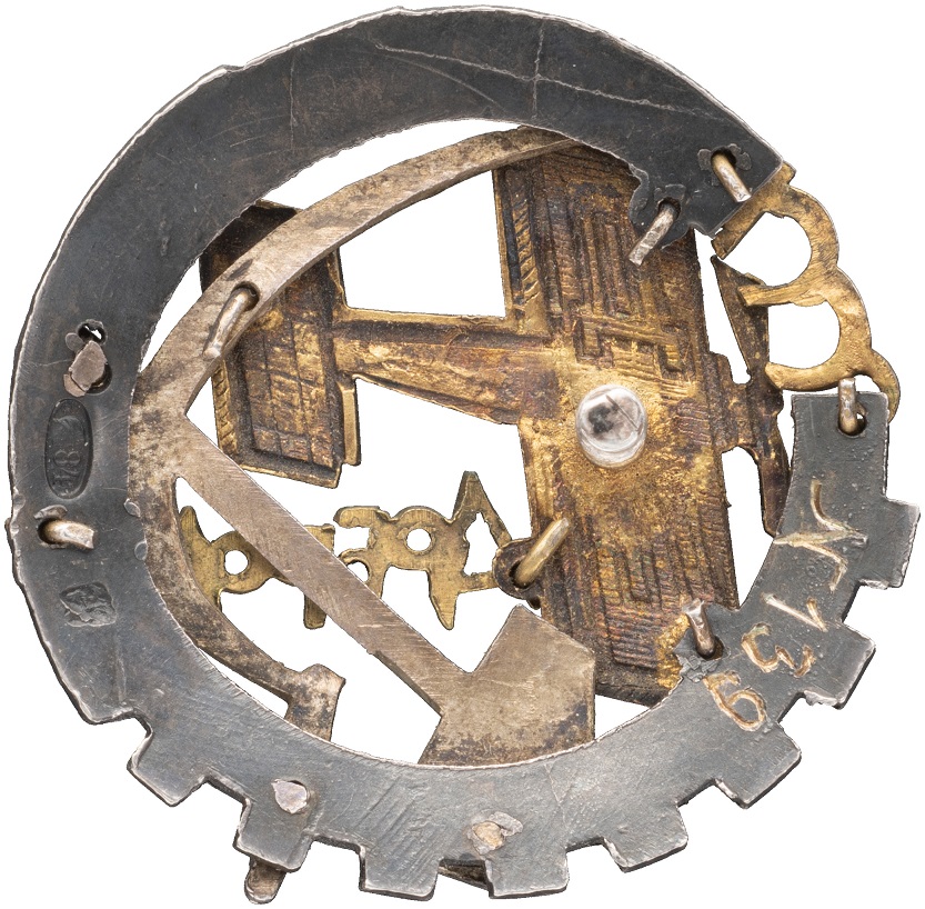

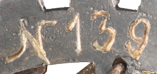

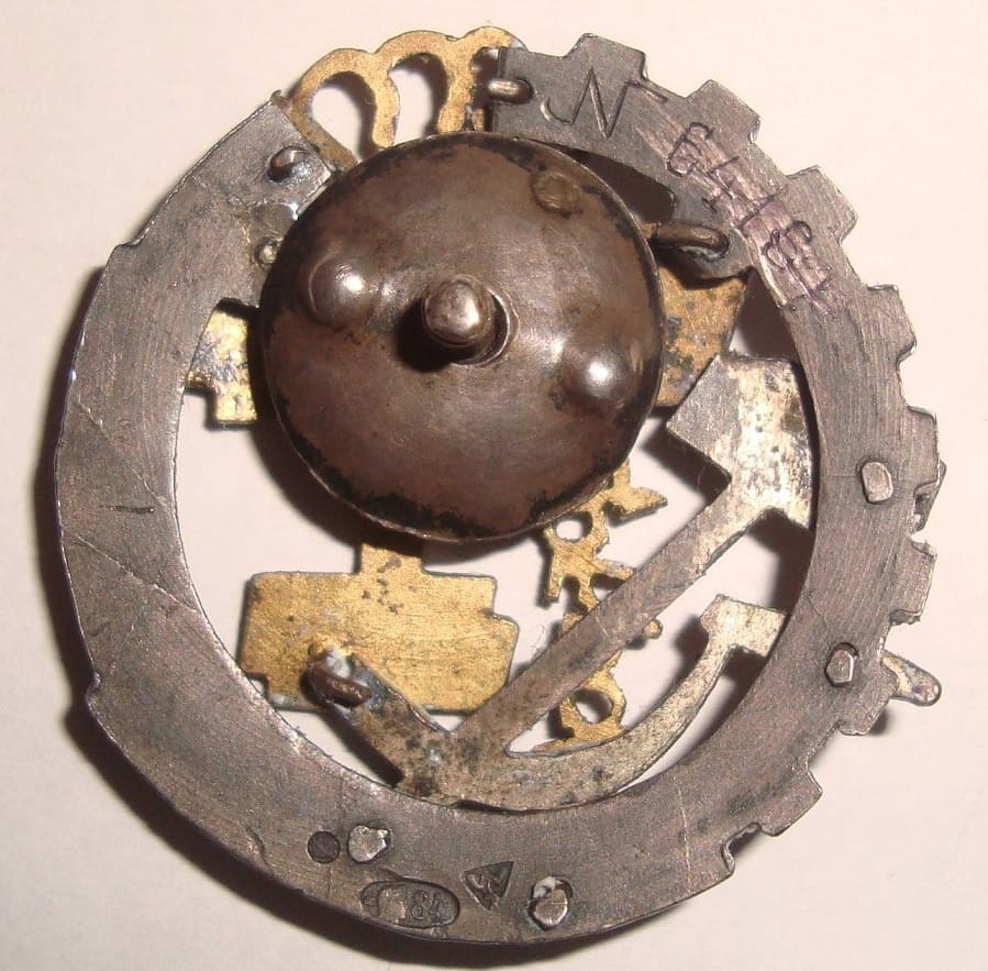

No. 139
Size 36.8 × 36.8 mm.
Weight 14.95 g.

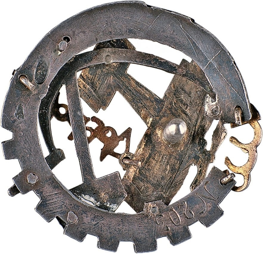

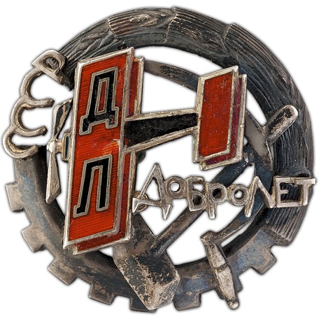

No. 203
Size 36 × 38 mm.
Weight 15 g.

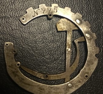

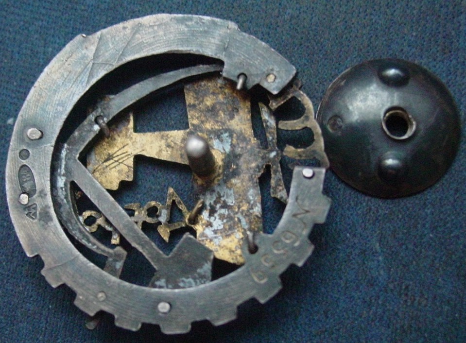

It seems that the earliest overlap between ТМ and ПВ badges happened somewhere between No. 187 and No. 225.

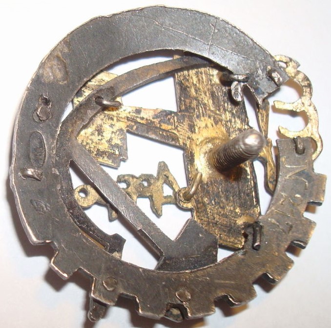

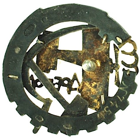

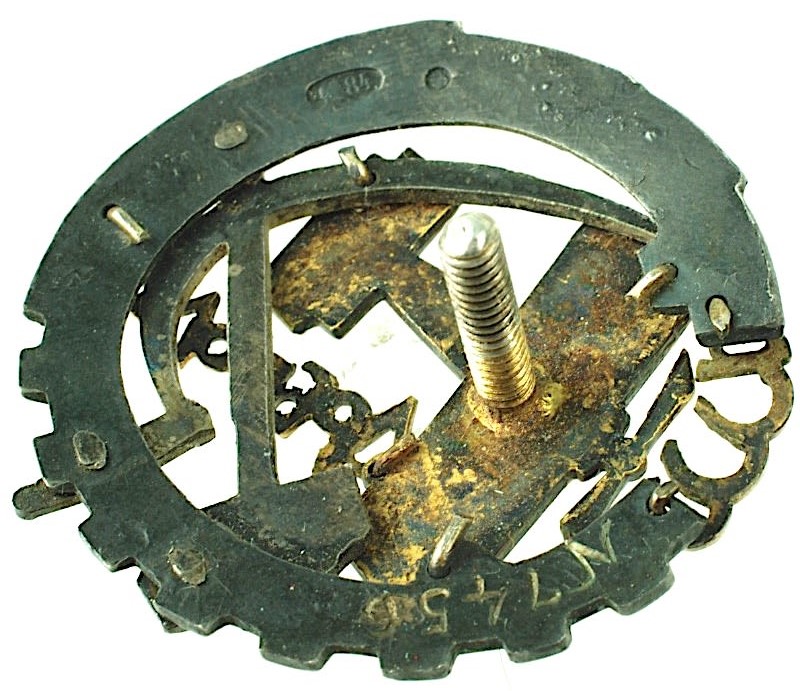

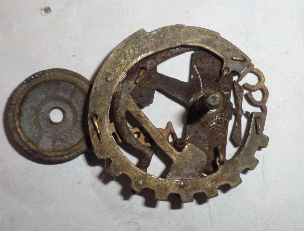

No. 225
Dug out badge.
Marked with "PV/ПВ" mark, Leningrad district assay office mark (alpha, female head in a kokoshnik to the right, 84) + round mark.

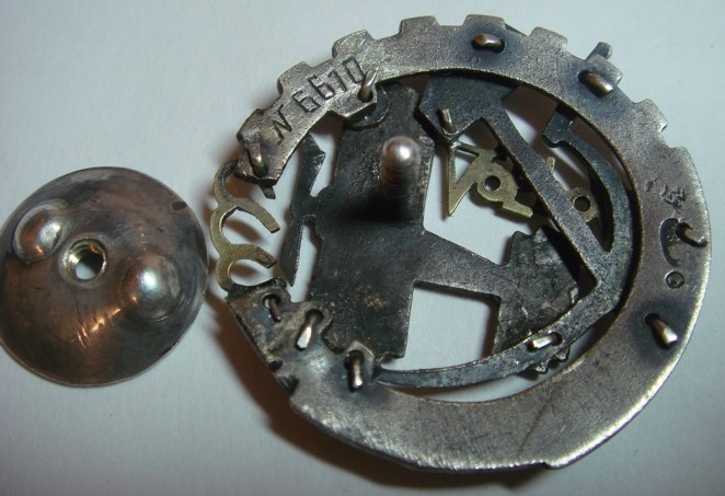

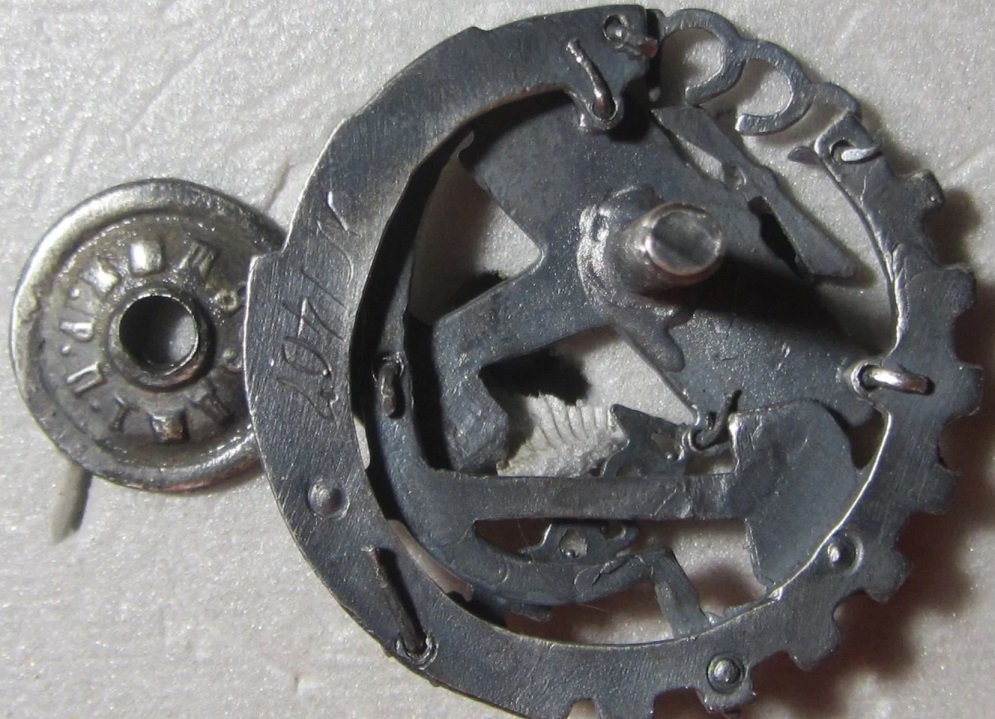

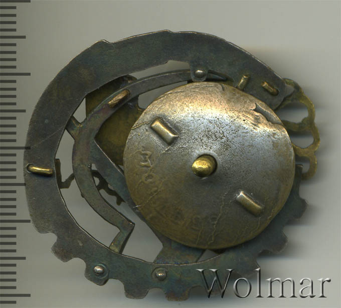

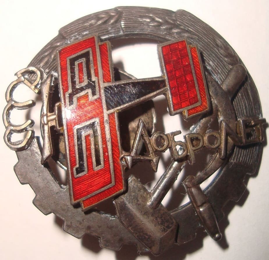

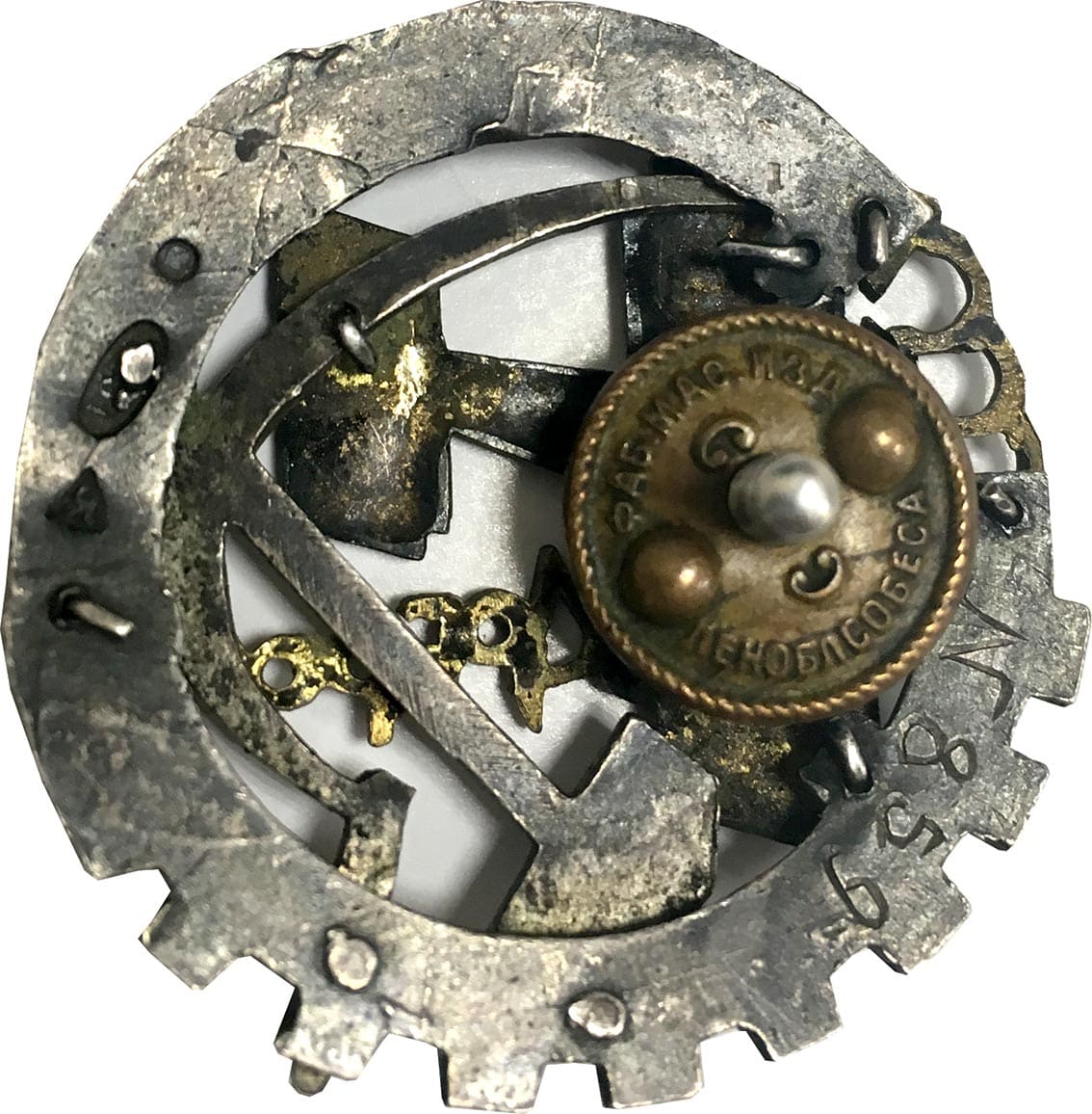

No. 859
Marked only partly readable "TM" mark, Leningrad district assay office mark (almost completely destroyed by the pin) + round mark.

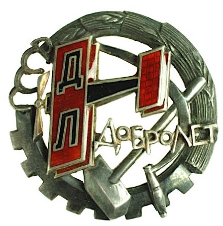

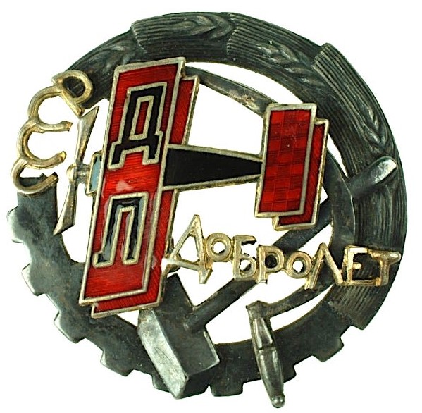

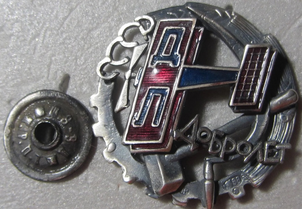

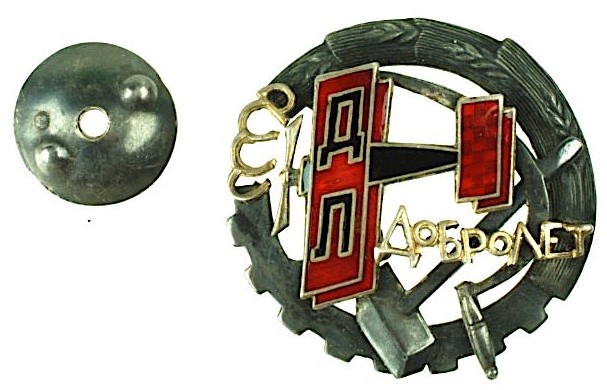

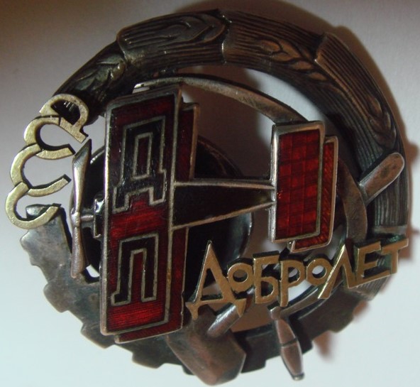

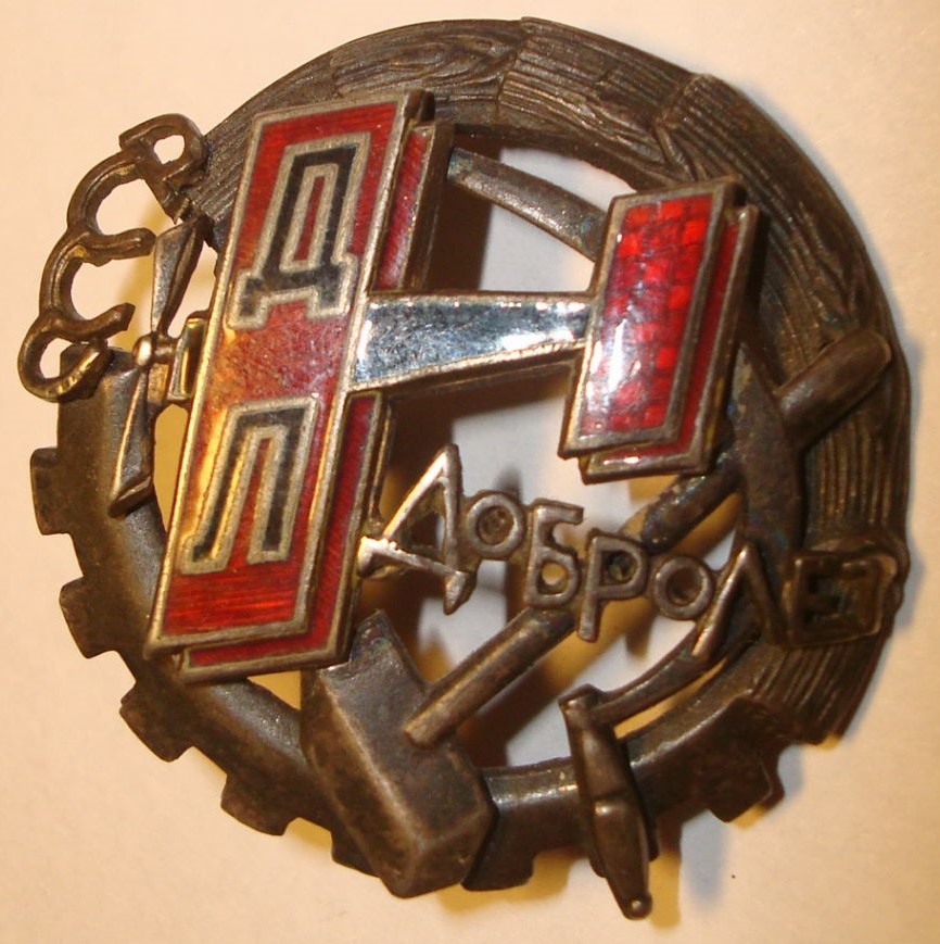

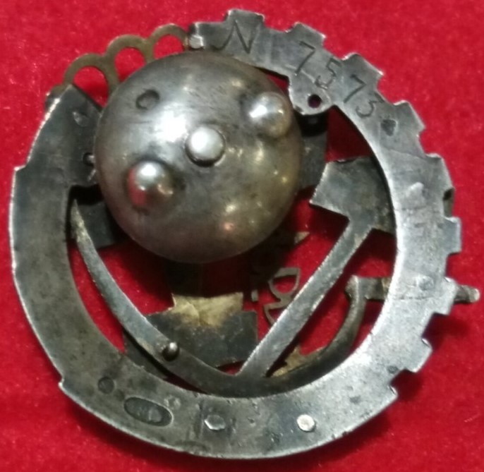

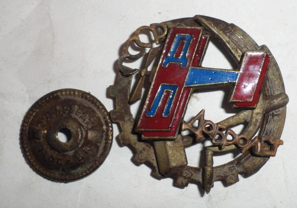

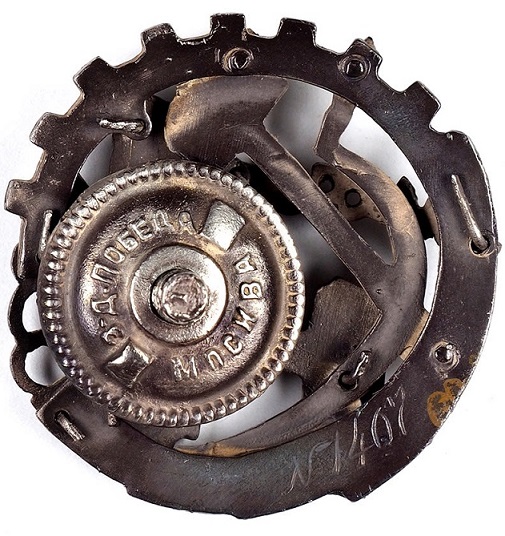

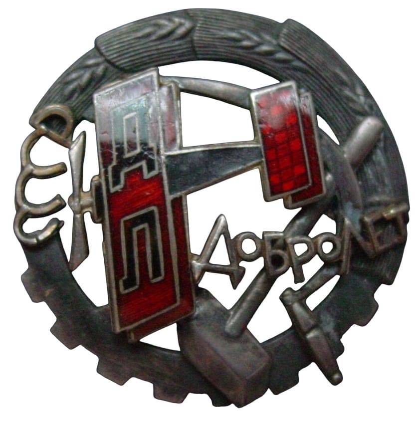

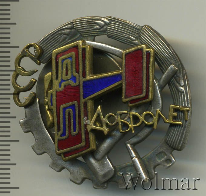

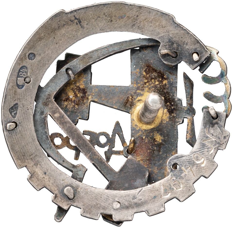

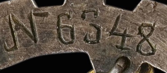

Fakes.
Probably the highest quality fake that is currently known.
Blue fuselage variation.

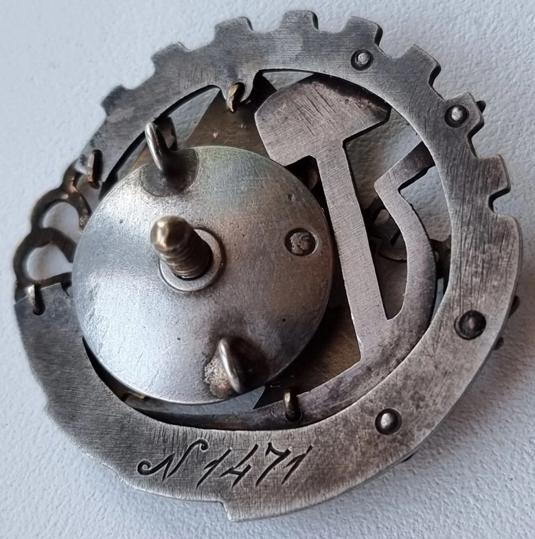

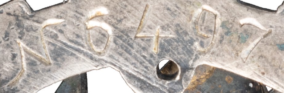

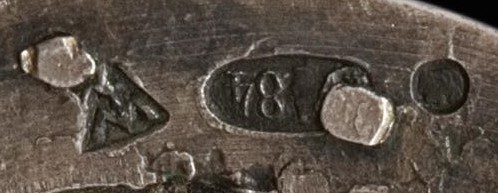

Fake marks.
Why they keep engraving the same No.1407 at reverses of this naïve fakes is a mystery.

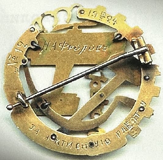

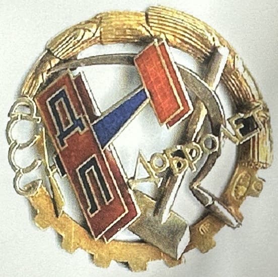

Gold badges.
Allegedly several dozens of early badges were made with gold (of 56th fineness). The only known for today such ПВ-made badge No.12 with additional engraving "October 12, 1924 [to] N.A .Florolov For Active Work/Н.А.Фролову за активную работу". Note that badge has pin fastening and additional rivets. Marked with "PV/ПВ" mark, Leningrad district assay office mark (alpha, female head in a kokoshnik to the right, 56) and round mark. Unfortunately, the quality of the photographs does not make it possible to confidently judge the originality of the marks.​
